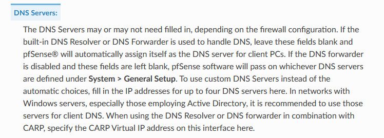

                @root1ng what are your settings in unbound? Did you set unbound to forward? Again what you set in general setup for dns is not going to be used by unbound unless you tell unbound to forward..
                Unless unbound is not running, if its not running then dhcp would hand out what you have in general.. And not that unbound stopped or something. If you set unbound to not be enabled, then dhcp would hand out what you have there vs pfsense IP.. Which I assume is what your x.x.1.1 is (not sure why you think you need to hide an rfc1918 address? 192.168.1.1??
                its noted in the docs
                https://docs.netgate.com/pfsense/en/latest/services/dhcp/ipv4.html#servers
