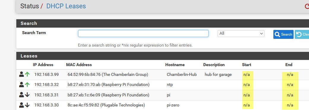

                    @Gradation7377 the entries in that file are your dhcp reservations..
                    Maybe your missing the reservation in the gui, or its on the wrong interface is why you not seeing it.. If you look in your dhcp leases status, do you see it there?

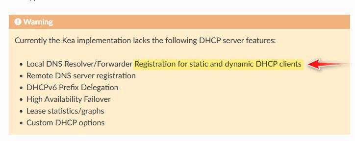

                        @Gradation7377 moving to kea sure not going to fix registrations.. It doesn't even support them of yet, so you could have a disconnect..
                        https://docs.netgate.com/pfsense/en/latest/releases/23-09.html#rn-23-09-kea
                        I would move back to isc dhcpd and figure out where you have the entry..

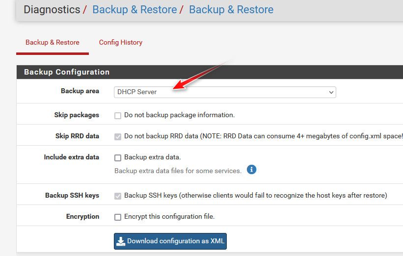

                            @Gradation7377 look in the dhcp server settings in the xml - is the entry in there.
                            Download that port of the config xml, and then open with your fav text editor - if in there you can remove and then restore that section of the config.

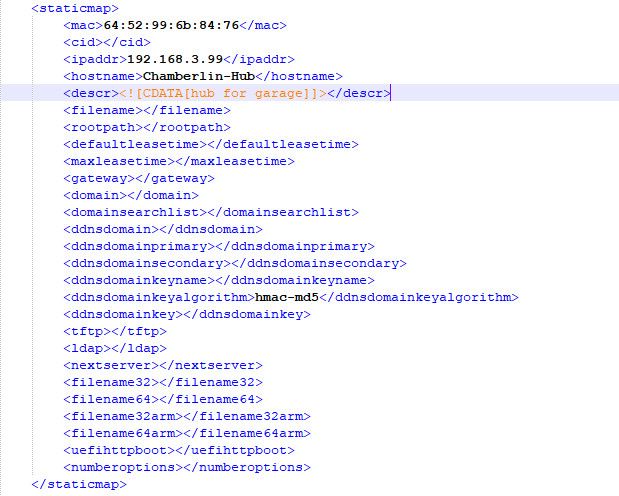

                            example - here is one of my reservations in the xml

                              Gradation7377 @johnpoz
                              Got it. It's there...Plus lots of others
                              Let me tidy this up and restore...
