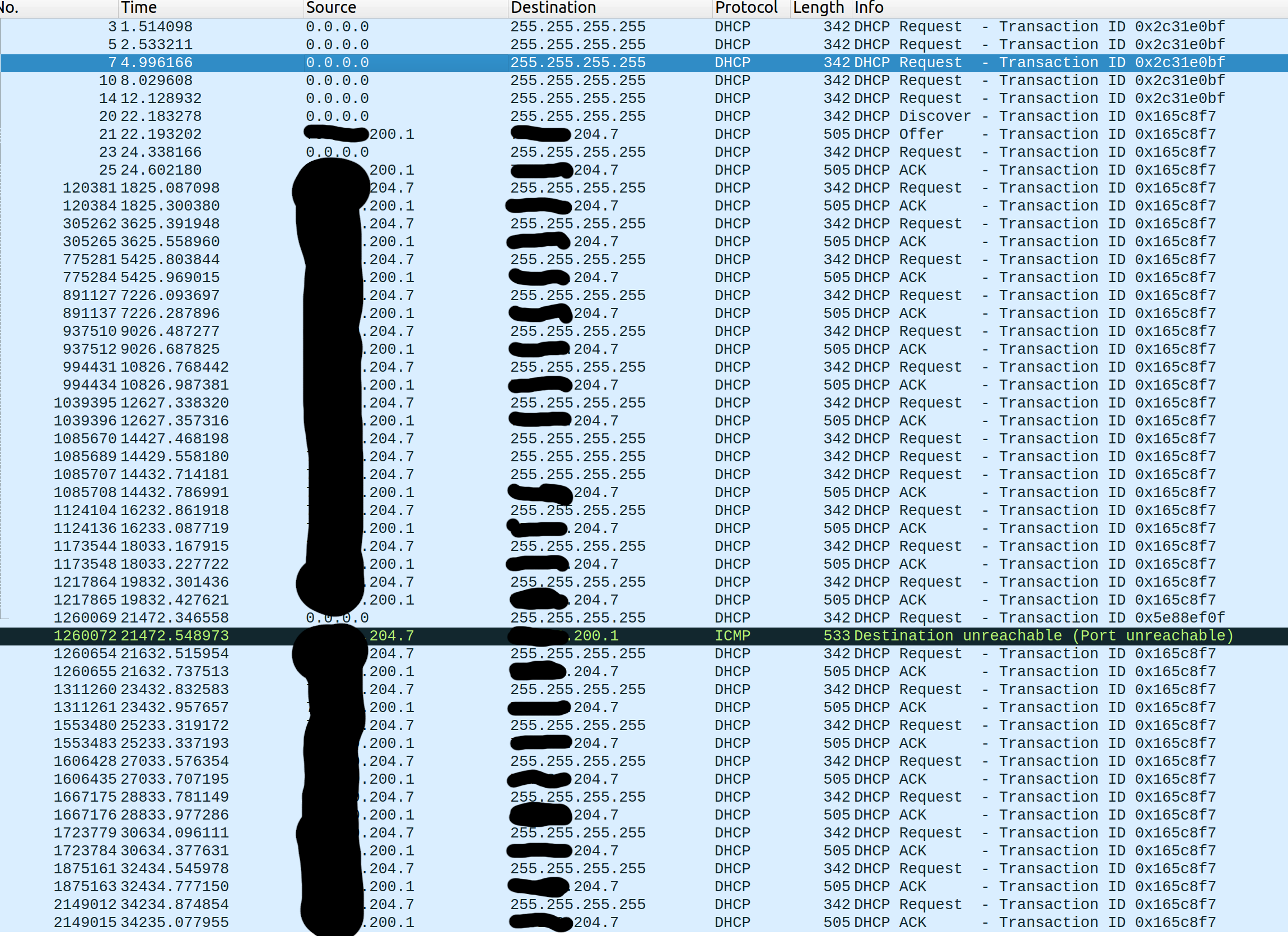

      DHCP Strangeness
      One of the things that I noticed was that the strange DHCP request was broadcast, and not unicast. An earlier thread in this forum mentioned that sometimes ONT units are misconfigured and can't properly forward DHCP requests. I added the suggested supersede dhcp-server-identifier 255.255.255.255 to no effect - everything was the same. Another thread on the internet mentioned that the ONT may need much shorter lease renewal, so I also added supersede dhcp-lease-time 3600. The DHCP trafic from the same trace can be see here:
      I also looked at the DHCP trafic on the Linux laptop. And lo and behold, the same pattern of a DHCP request broadcast from 0.0.0.0 followed by a DHCP ACK, and the combined ICMP (host unreachable) / DHCP ACK packet:
      I added a script to [ping 8.8.8.8 every 5 seconds, and that script detected the connectivity problem on the linux laptop, however only with one type of USB3 dongle as the network device. The same laptop, connected to a thunderbolt 2 docking station, still showed the the same pattern in the DHCP connections, but without degradation of the service - pings to 8.8.8.8 were successful immediately following the ICMP/DHCP (host unreachable) combo packet.
      FWIW, on the pfSense, the pattern happens with both Kea and ISC DHCP
