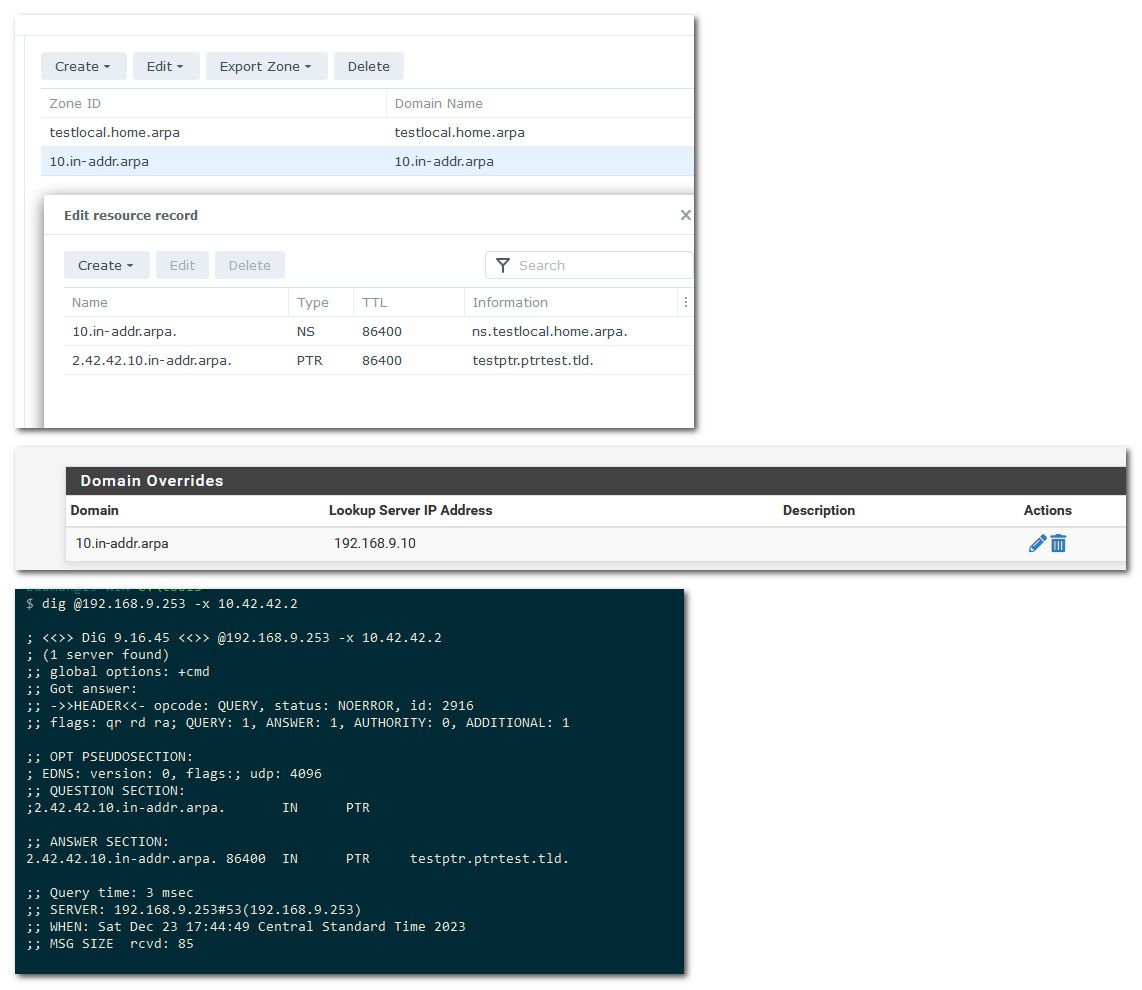

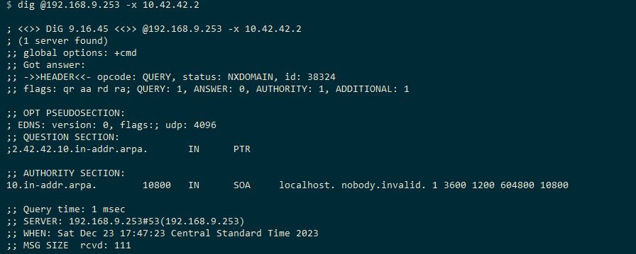

                    Here this is how simple it is -- I created a reverse zone on ns on my network at 192.168.9.10.. I setup the override in pfsense for an in-addr.arpa that would cover..
                    I query unbound on 192.168.9.253, it asks 192.168.9.10 and I get an answer
                    I remove the domain override - no worky worky ;)
