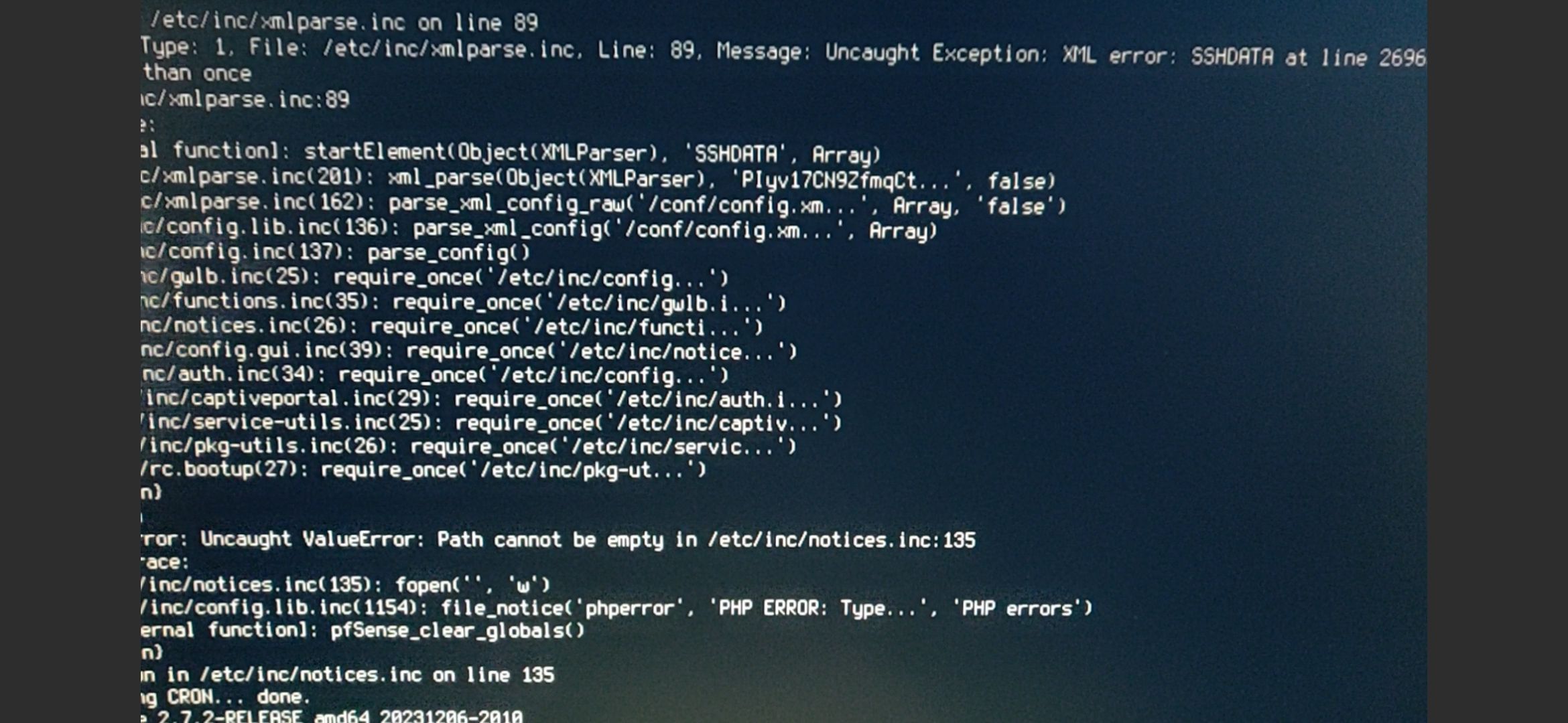

Freshly installed 2.7.2 failed to restore the config with removed packages:

@pfthbst said in Empty field "Firmware Branch" in <System/Update/Update Settings> after a fresh install v2.7.2:
I installed a fresh version 2.6.0, successfully restored the config, removed all packages, made the config backup with RRD and extra data included.
Freshly installed 2.7.2 failed to restore the config with removed packages:That looks like this: https://redmine.pfsense.org/issues/13132
That should be fixed but it's possible you found some variant on that. However you should be able to manually remove the rogue sshdata section from the config and then import that to 2.7.2. -
Thanks for the advice!I removed redundant <sshdata> section from 2.6.0 no-packages config.
