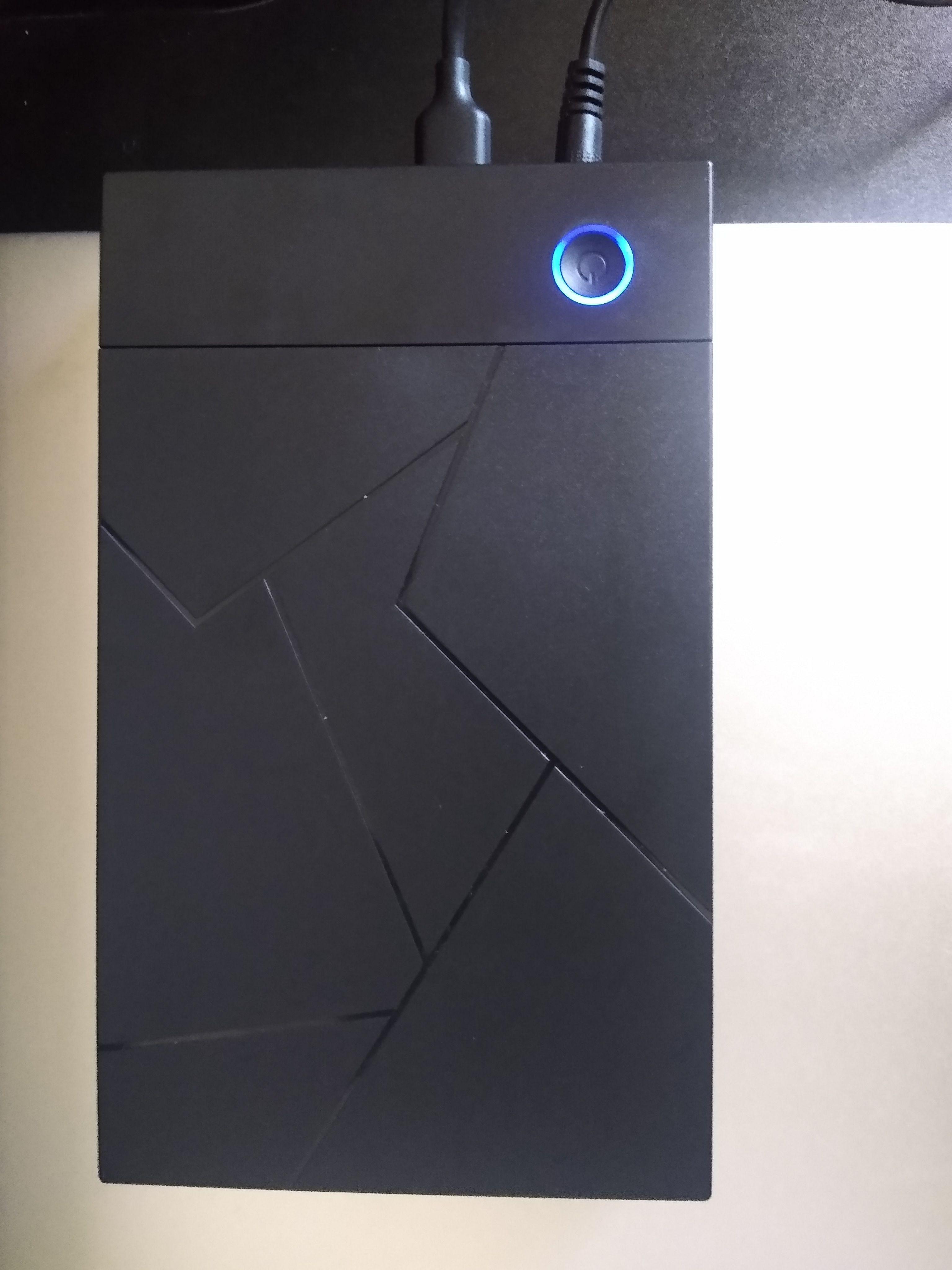

                  I couldn't just throw it out... Again my wife says I am an electronic hoarder.
                  It works great for a USB drive this thing won't die it's a Western Digital. The sound of it spinning up is so satisfying. I use to have 10K rpm drives back in the day, the spin sound is relaxing. I have a microHDD also it's a compact flash HDD, the coolest USB drive because it also makes spin up sounds just really micro.
                  Screenshot_20231224-090027.png Screenshot_20231224-090043.png !
                  I can't even figure out what to put on 350GB to fill it up, let alone their new 20TBs.
