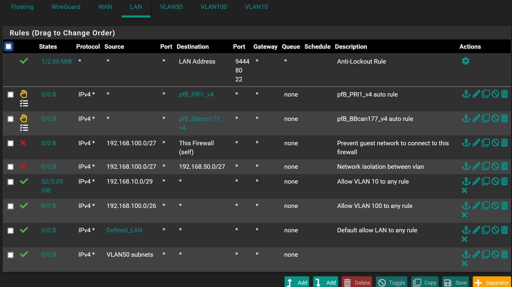

          Methraton @johnpoz
          @johnpoz thanks for the checklist !

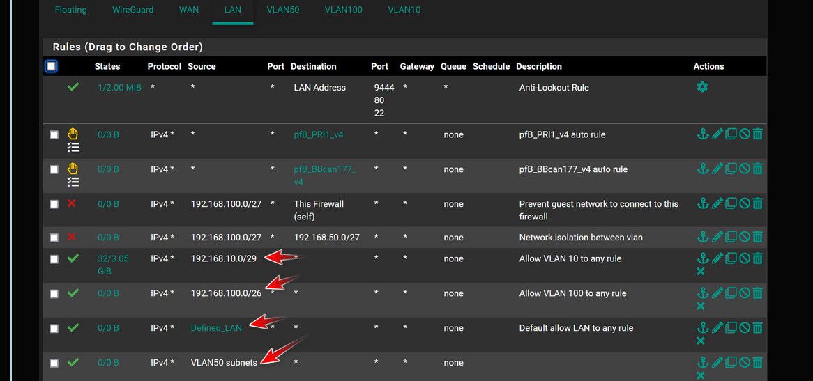

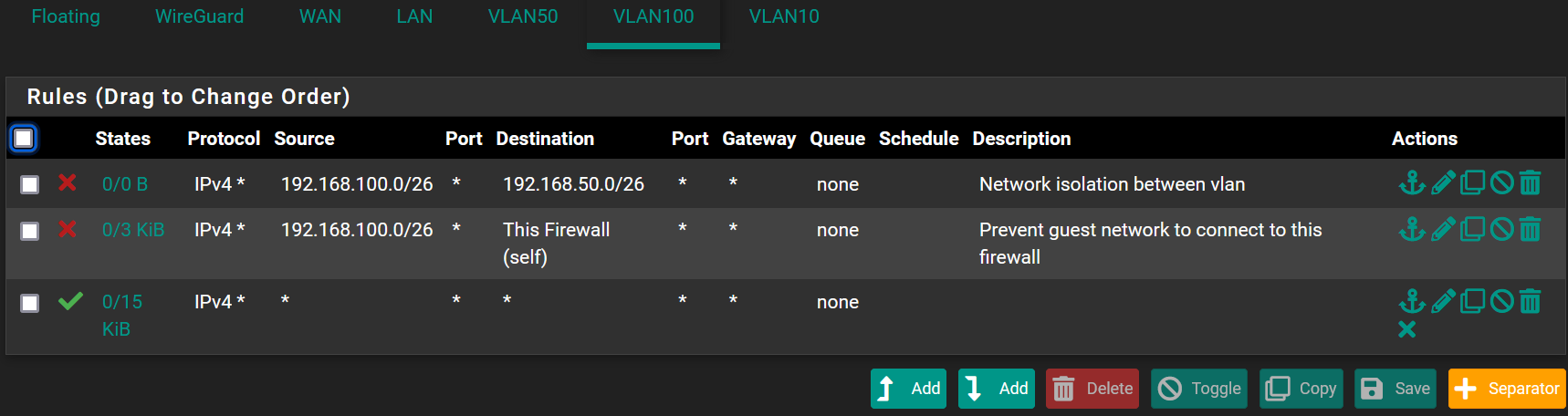

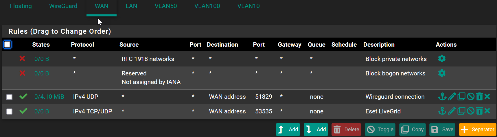

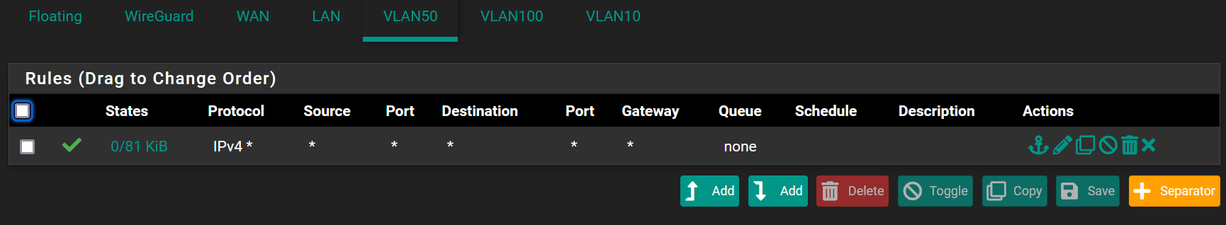

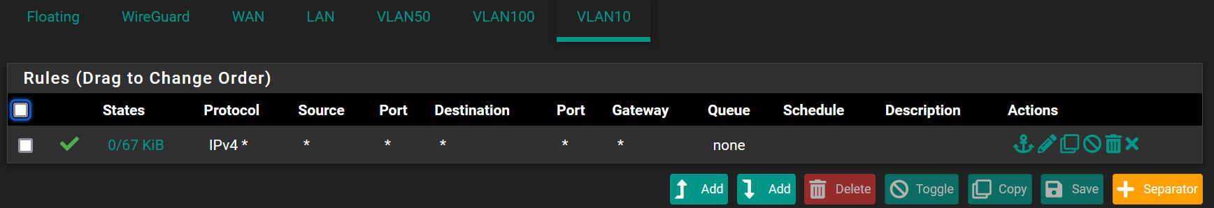

          So the only rfc1918/bogon rules are only defined on my WAN interface, the VLAN rules are very very open (simplest is to show it here):
          and I can't see anything relevant in the system logs....
          Thanks !!

            johnpoz LAYER 8 Global Moderator @Methraton
            @Methraton on your vlan 100 your blocking access to anything on the 192.168.50 network, So no that vlan100 would not be able to start a conversation to anything in that network.
            And you blocking access to every IP on the firewall, so no you wouldn't be able to ping pfsense IP address on the 192.168.100 or any other IP of pfsense.
            Unless the device on the vlan100 was using some external dns, it wouldn't be able to ask pfsense for dns either with those rules.. So Its not going to be able to go to www.google.com even unless it was using something external to resolve www.google.com
            Rules are evaluated top down, first rule to trigger wins, as traffic enters the interface from the network its attached too.
            edit: these rules look pointless.. What is the network on your LAN, sure isn't 192.168.100 or 192.168.50? That traffic would never be source into pfsense lan.. Is your lan network 192.168.100/27 ?? how would that be source of traffic into the lan interface? Going to anything on the firewall or the 192.168.50/27 network??
            The only traffic that would be source inbound into the lan interface, is the lan subnet.. What network do you have on LAN, that is the only thing that could be source into the lan interface. Unless you were using lan as a transit/connector network - and if that was the cause you wouldn't create vlan interfaces on pfsense..

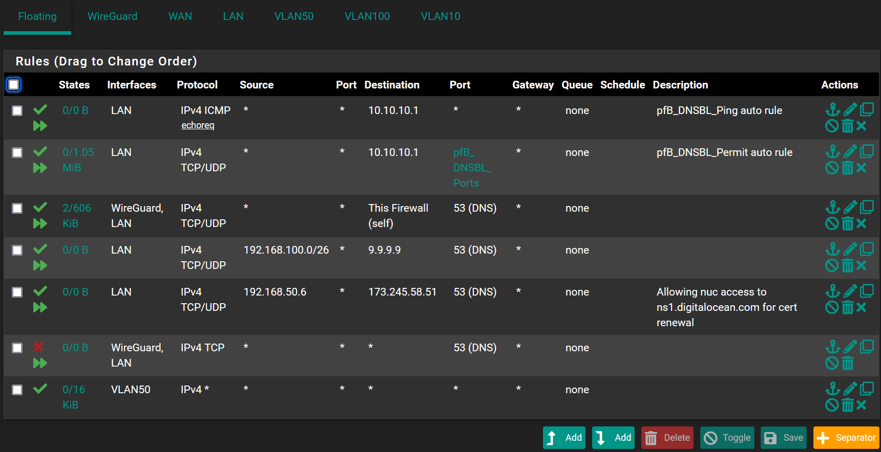

            To be honest the whole thing looks a mess, all those rules on floating only make for complexity.. If you don't want vlan X to go so some where, or you want to allow it to do something - put the rule on the interface not floating..
