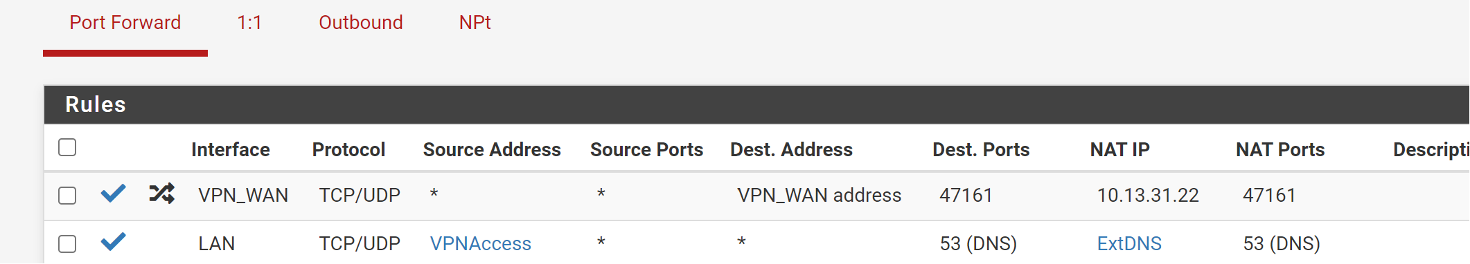

Firewall -> NAT -> Port Forward:

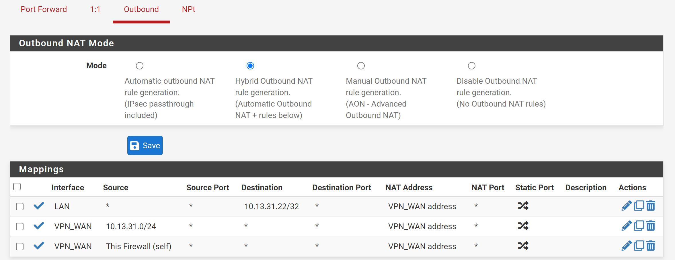

Firewall -> NAT -> Outbound:

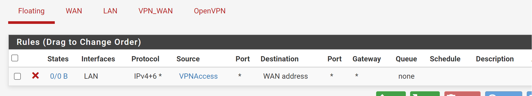

Firewall -> Rules -> Floating (To block VPN Addresses from using WAN IP directly)

Does it even listen on port 47161?Firewall -> Rules -> Floating (To block VPN Addresses from using WAN IP directly)
This rule only blocks the host in the stated alias. But this makes no sense, since any traffic from this alias is directed to the VPN gateway by LAN policy routing rule and if the rule is omitted due to the gateway is down, any traffic is blocked by the next rule.

Add an outbound NAT rule for the incoming traffic:
Interface: LAN
source: any
destination: <server IP>/32
translation: interface addressCheck if you get access from outside.

It's local IP.Edit:
also flush the states after adding the rule. -
No change. To confirm:
NAT:

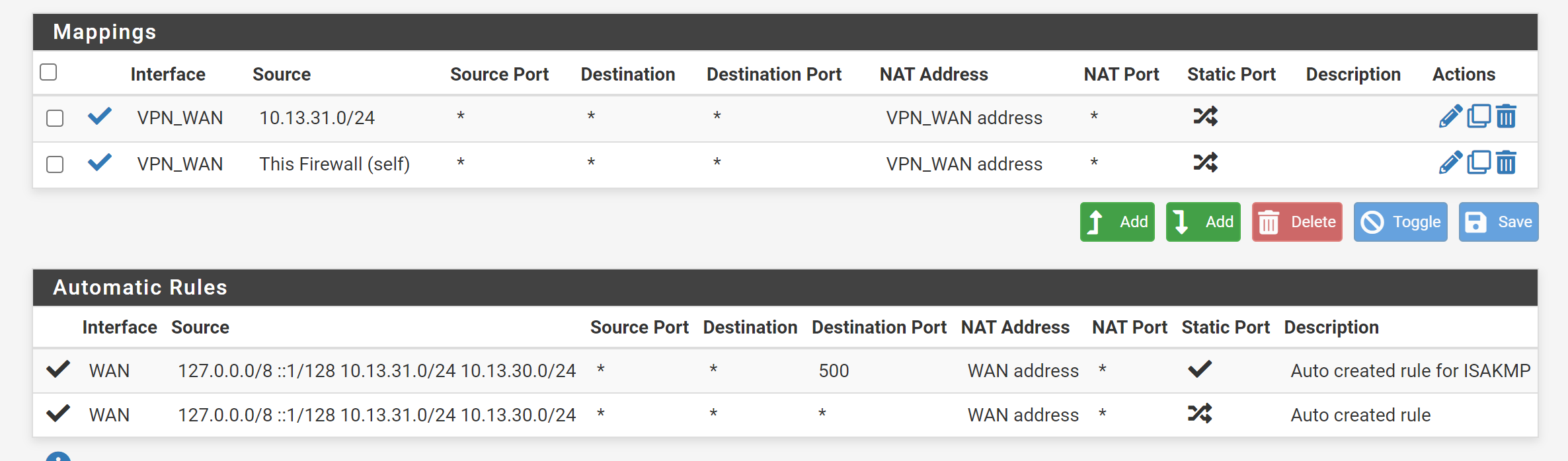

Outbound NAT:

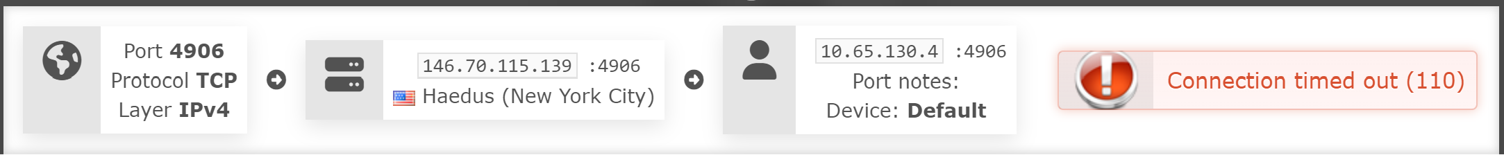

VPN Provider Port Check Tool: (Note, telnet to the public IP from an outside IP (ie: an Azure VPS, yields the same result)

@techboot said in Port Forwarding w/ OpenVPN Tunnel - What am I doing wrong?:
NAT:
And the mess goes on...
10.13.31.22 is your VPN interface address. The NAT IP has to be your internal server IP!Also you should limit the destination IP. Your may set it to the interface address.
@techboot
Ah ya. So you need to edit the outbound NAT rule and correct the destination IP. -
