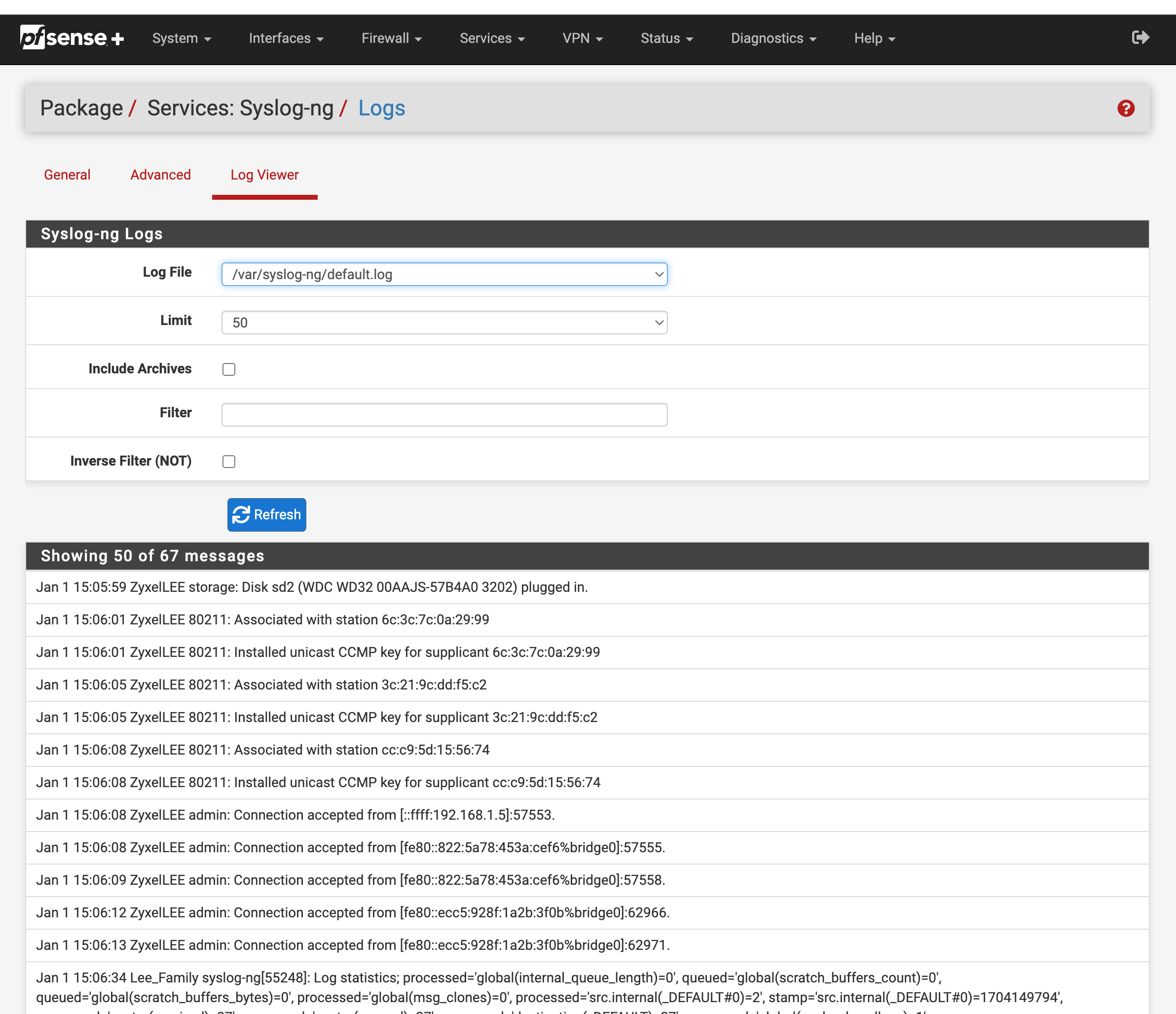

      Hello fellow Netgate community members,
      (Airport Extreme Logs, don't ask why it is named Zyxel :) )
      I wanted to share a quick how to guide to make your external AP system send syslog events to pfSense. You can setup pfSense to be a log server for syslog events. Keep in mind Airport Extreme logs only can be seen with some versions of Airport Utility, this causes issues with accessing them, as normally users can not see them with the version that is on Mac OSX, only with the older version and or the version that is made for Windows.

      Bingo!! You got all your logs in pfSense without ever having to log into your Airport specific software to see them. You can see who accesses the NAS, shows connected.
