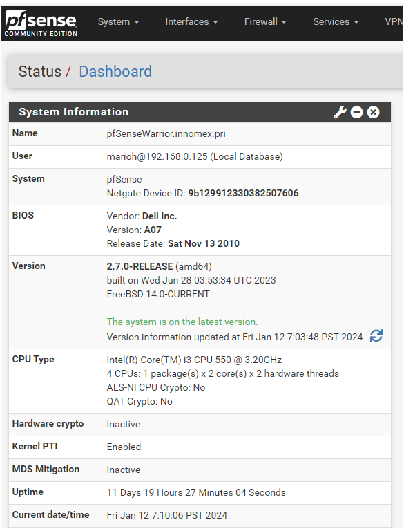

          thanks for your prompt reply according to your answer it should work but it isn't, I just tried for the third time with the same result, after I load the configuration backup file to the 8200 and restarted it gets hang up on the booting process, the 3 leds keep bilnking fast.
          I attached the screenshot of the version screen of both devices.
          Regards
            What NICs does the CE device have? If it only has assigned NICs that actually do exist in the 8200 then it will just try to use them rather than asking you to reassign them.
            Since you have Netgate hardware you can open a ticket with us and have the old config converted so it will import directly.
