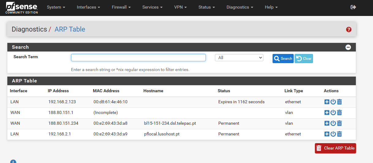

        I currently have internet and my arp table looks like this.

          Ok so see if it fails when that ARP table entry for the gateway IP expires or before that.
          S 1 Reply Last reply Jan 16, 2024, 4:00 PM Reply Quote 0

            ARP table (without internet):

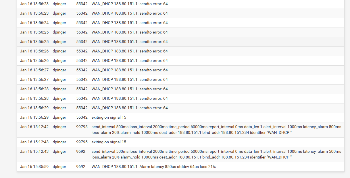

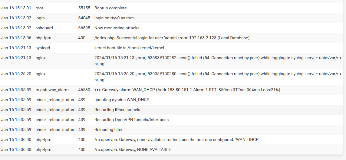

            System logs:
            Gateway logs:

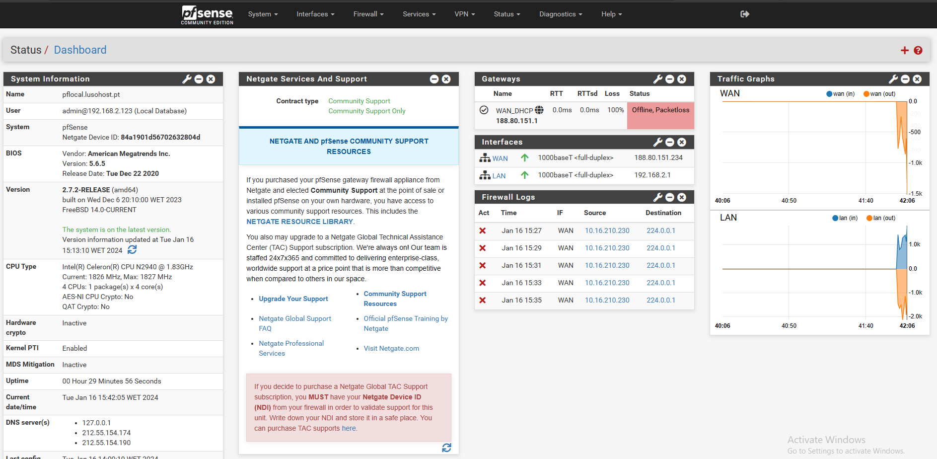

            Interfaces status (without internet):

            Arp table expired gateway:

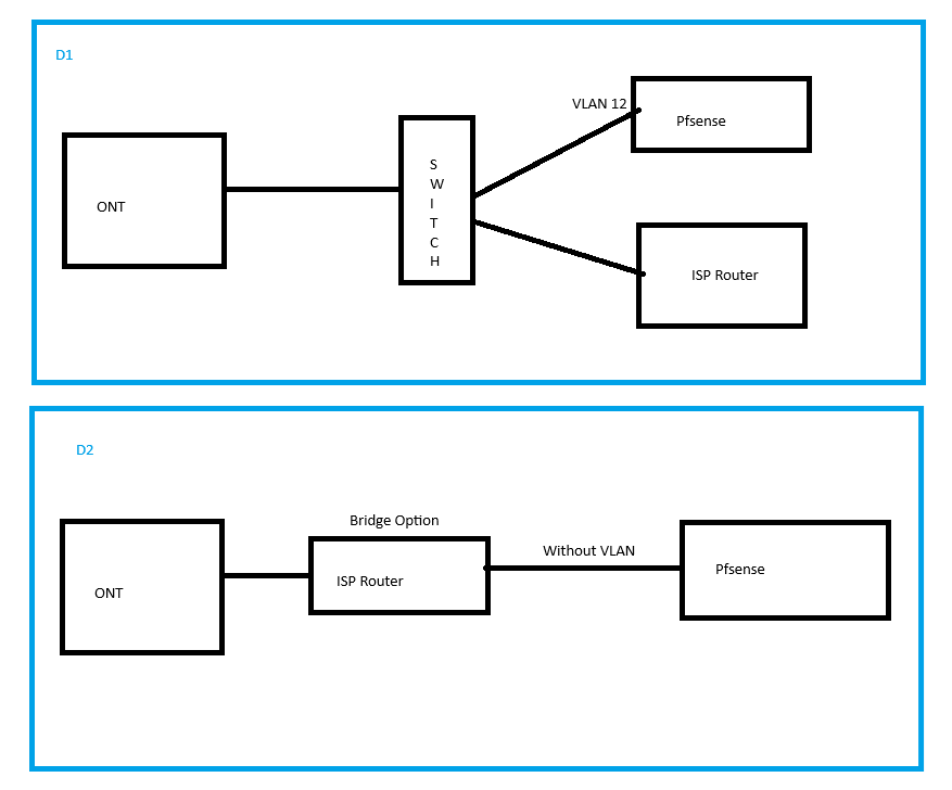

                    Removing and inserting the cable didn't work and the commands on the terminal didn't work either. What I said about having to wait an hour to get the IP address again is a lie. If you disconnect the power and turn it back on, you will immediately get the address and you will have internet again.
                    I was on D1 and now I changed to D2 and the problem no longer seems to happen. But I needed to have pfsense connected directly to the ONT since pfsense and the router are in very distant locations.
                    The IP obtained through DHCP is the same
                    S 1 Reply Last reply Jan 16, 2024, 10:41 PM Reply Quote 0

                      Everything is working perfectly but I needed pfsense connected directly to the ONT.
                      • S
                        Ah so both pfSense and the ISP router are pulling IPs from the ISP in the D1 setup. That's not normally allowed, an ISP would usually only provide one IP address.
                        Why do you need pfSense connected to the ONT directly?
                        Why do you need the ISP router at all?

                          For two reasons. The ISP's router and the other router will be in distant locations and they didn't want to have both connected as the distance is too far. I will have two networks, one for the servers and one for home. I need ISP's router because of IGMP and VOIP.
                          I tried turning off the ISP's router, leaving only pfsense on and even then, after a while, pfsense no longer has an IP address.
                          A user from my ISP made a tutorial on how to use pfsense connected directly to the ONT but it is in Portuguese.
                          https://forum.meo.pt/internet-fixa-e-movel-11/tutorial-pfsense-87365
                          An interesting point. In D1 without the ISP router (and without a switch, a test to see if it could be the switch but that wasn't the problem), that is, the RJ45 cable connected directly from the ont to the pfsense, I restarted the pfsense normally without turning off the power and the pfsense after the reboot does not pick up IP but if I remove the power cable and return Putting it on immediately and pfsense boots much faster.
                          The only problem that I am detecting could be that the vlan is directly associated with the wan port and could be causing some conflict but it is just an assumption since without the vlan with the bridge option on the ISP router it always works without problems.
                          S 1 Reply Last reply Jan 17, 2024, 11:14 AM Reply Quote 0

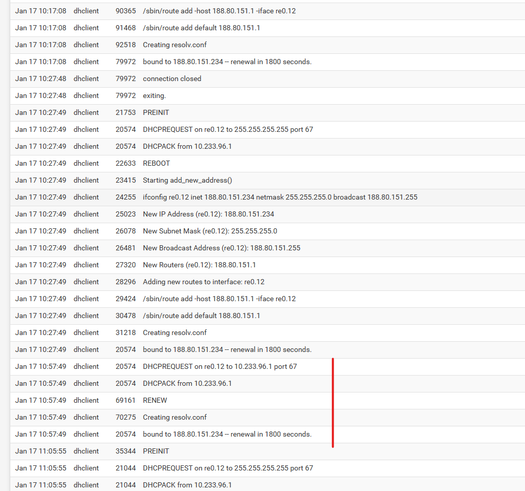

                            It doesn't seem to be from my ISP's DHCP server. pfsense has now been on for about 45 minutes and has made the IP renewal request twice without a problem. Here he got the IP address and after about 5 minutes it stopped showing.
                            I then removed the power cord and got the address again at 11:05.
