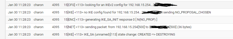

            patrick.pesegodinski
            This is the log that appears when the main link returns and IPSec does not connect. The connection is only reestablished by restarting the IPsec service.
