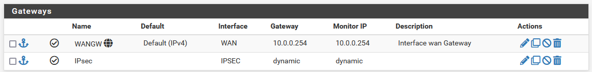

      The tunnel seems to work fne, as from 10.0.0.8 I can ping 10.80.70.11 without any problem. I configured IPsec in VTI mode and created an interface as explained in the docs:
      alt text

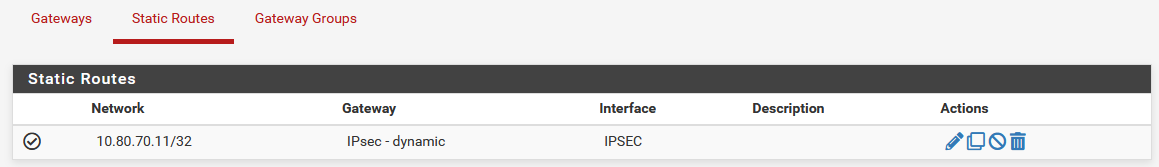

      After verifying that packets from my local machines for 10.80.70.11 are correctly routed to 10.0.0.8, I added the following static rule:
      alt text
      Unfortunately, this doesn't seem to work for me. When I go to the Diagnostics > Routes tab, this route is not shown. Local testing on 10.0.0.8 shows that the route doesn't exist at all as 10.80.70.11 gets triaged into 0.0.0.0:
