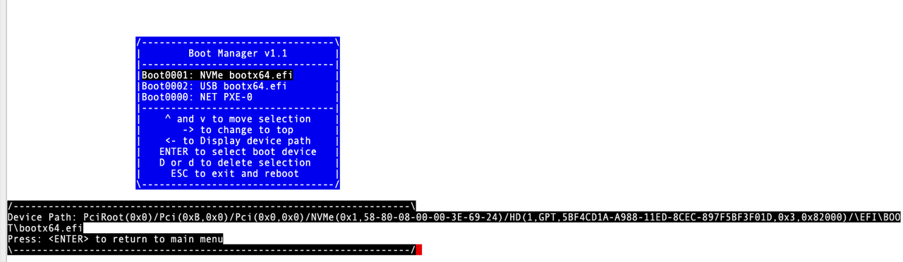

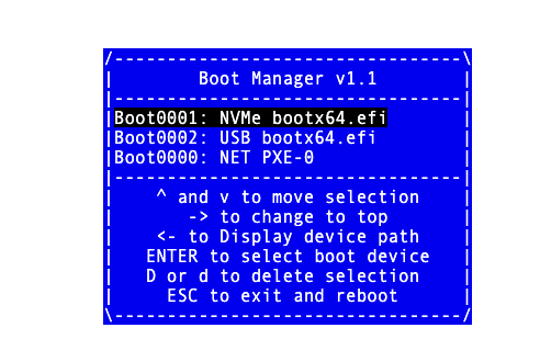

Screenshot hopefully gives a good indicator of what I'm seeing. Selecting NVMe here just drops me directly back to this same menu again.
Here is the menu option after selecting < to show the path:

If you select the NVMe drive and it just goes back to the menu that implies it's an invalid UEFI variable. Which means it's probably the old entry from before the install.
I expect a new entry to be added at first boot. You should then be able to move the USB device entry below that valid NVMe entry to it boots NVMe by default.

The internal drive is already at the "top" of the list. I have tried selecting it manually (this returns immediately back to the boot menu again endlessly) and also tried letting the device "naturally" boot without selecting boot options (this will load USB installer).

Have you tried resetting the boot menu options? That should then generate a new entry for the NVMe that is valid at the next boot.

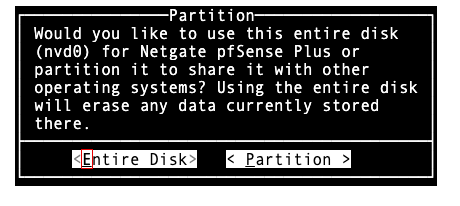

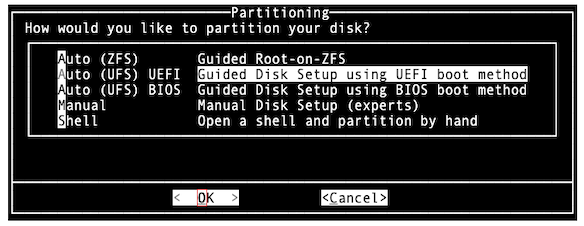

I would like to fully wipe the disk clean and reinstall as perhaps something is left over from the 23.01 install that the device shipped with (which was quite broken with tons of errors such as "/usr/local/sbin/pkg: Undefined symbol __libc_start1@FBSD_1.7" and others).I also thought about wiping the existing partition structure using the UFS guided setup (I've been doing the ZFS default "auto" config during install so far). However when I get to the partition editor menua it lists my USB drive da0 so I was a bit scared of wiping the USB disk in the process....
For example, trying UFS guided disk setup ( I have been choosing "Auto (ZFS)" previously):
Here is where I'm worried about it wiping my da0 disk. Wiping the installer media would literally take days to recover it with on-site staff out on the opposite side of the globe.
Is it safe to proceed here and it won't re-partition my da0 device? My goal is to clean wipe and reinstall on nvd0.

Yes you could safely install UFS from that screen but it won't help here. You should use ZFS anyway.
