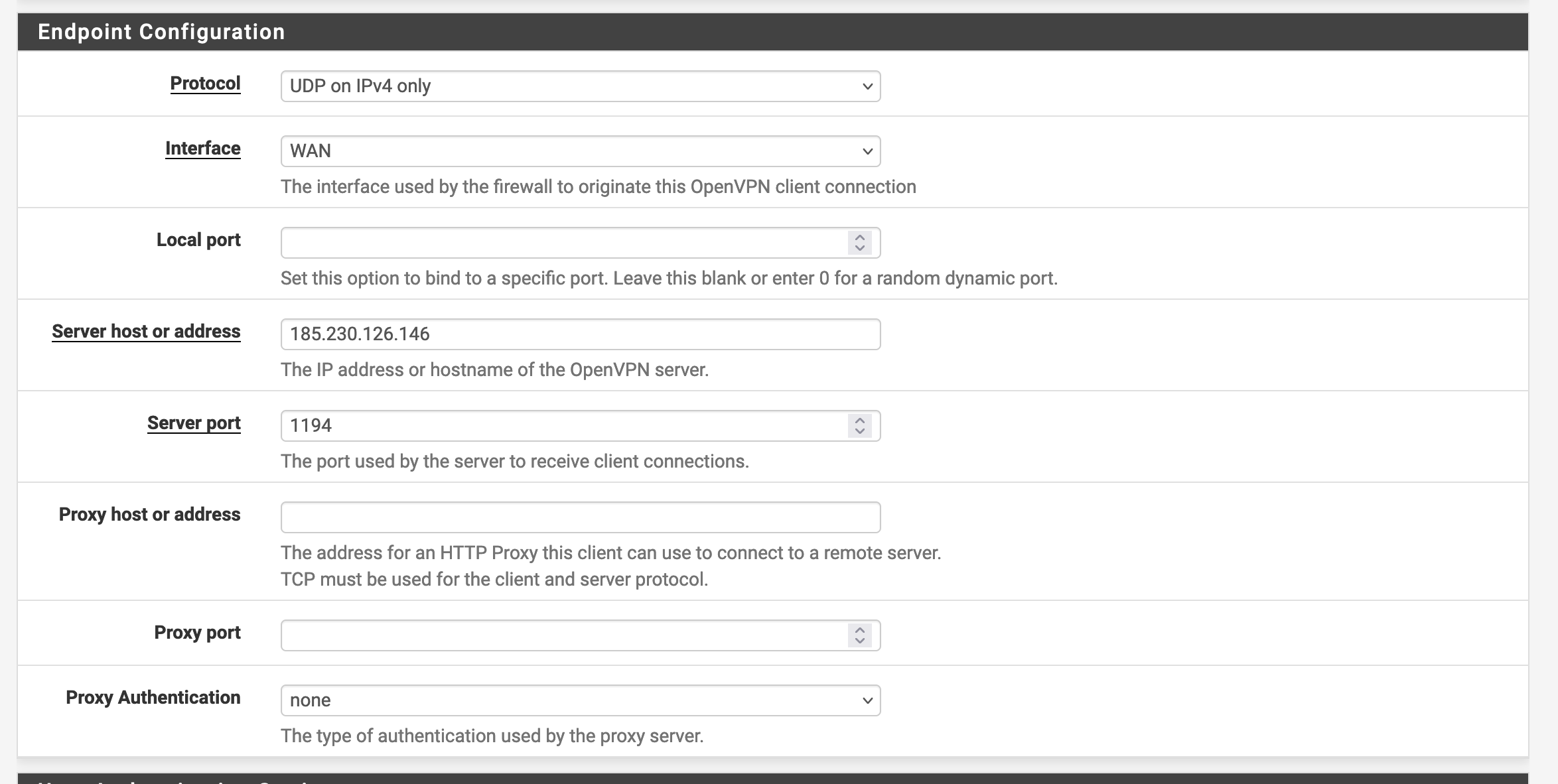

          @Dobby_ I have no real netoworking knowledge, so im not sure what this means. I know what an IP address is though. I set everything up per instructions from a book.
          My endpoint settings have an IP Address I specified.
          • V Offline
            viragomann @fiyawall
            @fiyawall said in Help with PfSense not working after getting new modem:
            My problem is I cannot get the internet up on the firewall.
            So how do you get the internet normally?
            Do you have an IP on the WAN of pfSense?
            If not, how is the WAN interface configured?
            The screenshot in your second post might show an OpenVPN client setting page. But this has nothing to do with the basic internet connection of pfSense.
            Usually when the connection was down, i would reset the credentials and it would come back up.
            Which credentials? Where?

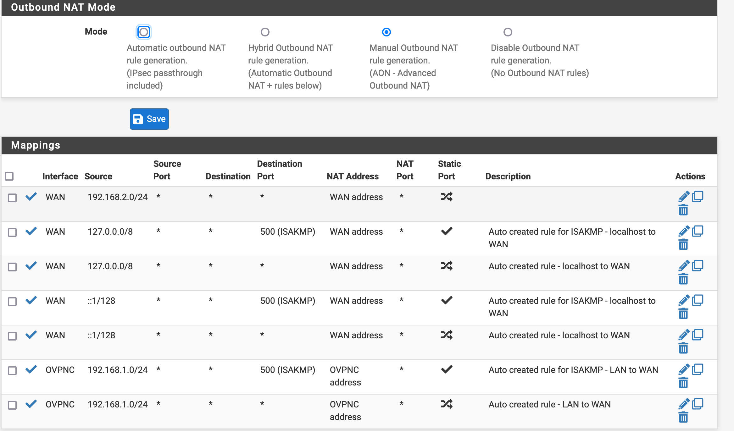

                    If this fails, post a screenshot from the Firewall > NAT > Outbound page.
                    If the ping works, post some more details of your network.

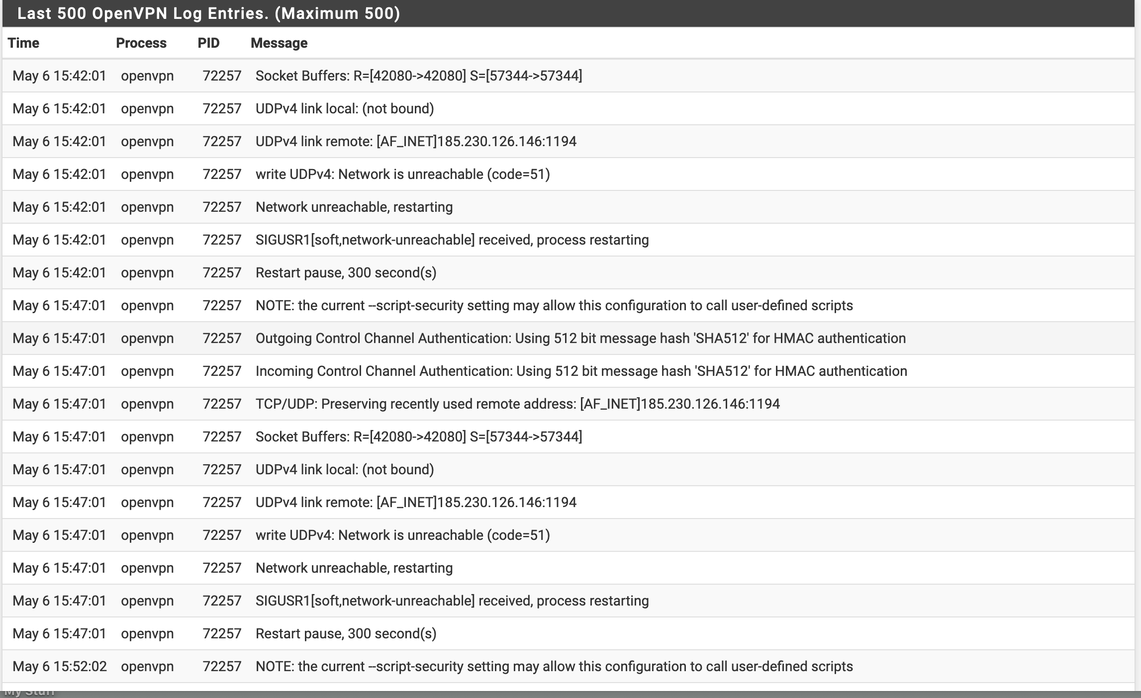

                    • F Offline
                      fiyawall @viragomann
                      @viragomann
                      I'm not even sure how to verify if the VPN "connects", I'm not even sure what I would look for.
                      Also, I'm not sure what a client is.
                      As for the ping, do I just copy and paste that into my browser, as you wrote it?
                      Below is the two things you requested. OpenVPN log and then the Outbound page.
                      Screen Shot 2024-05-06 at 12.27.03 PM.png Screen Shot 2024-05-06 at 12.28.07 PM.png
                      • V Offline
                        @fiyawall
                        Huhh! Could be a a long, hard road.
                        Your client cannot connect obviously due to some reason.
                        First of all, switch the outbound NAT into automatic mode to rule out issues with this.

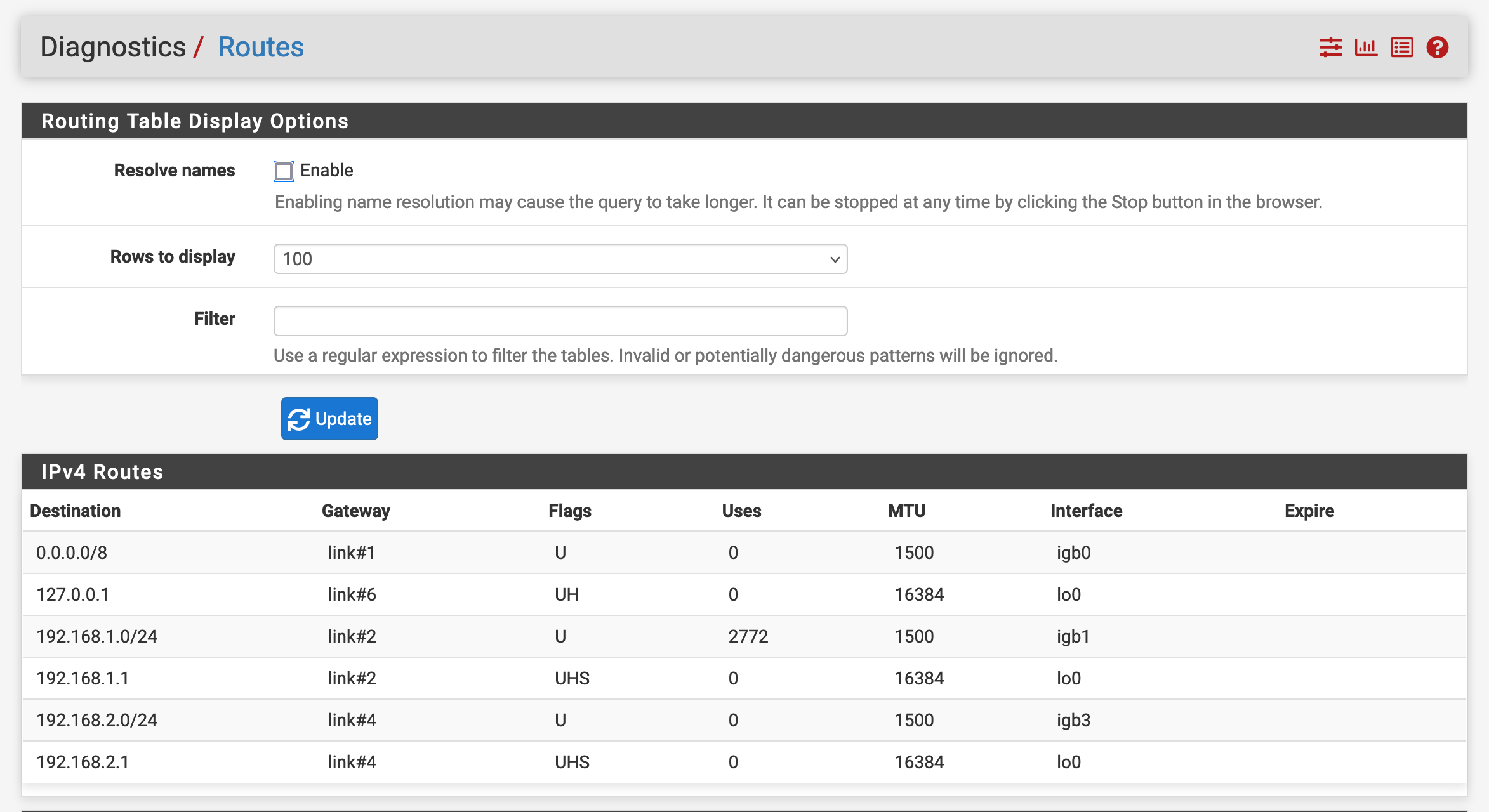

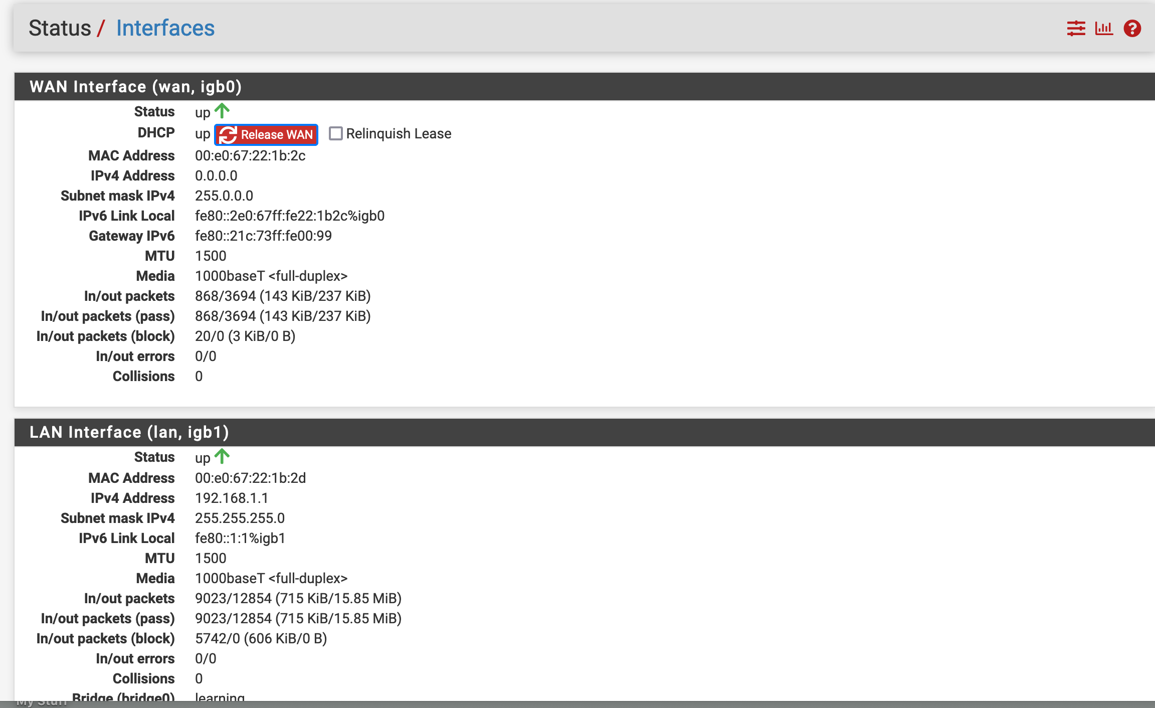

                        Then post some screens, please:

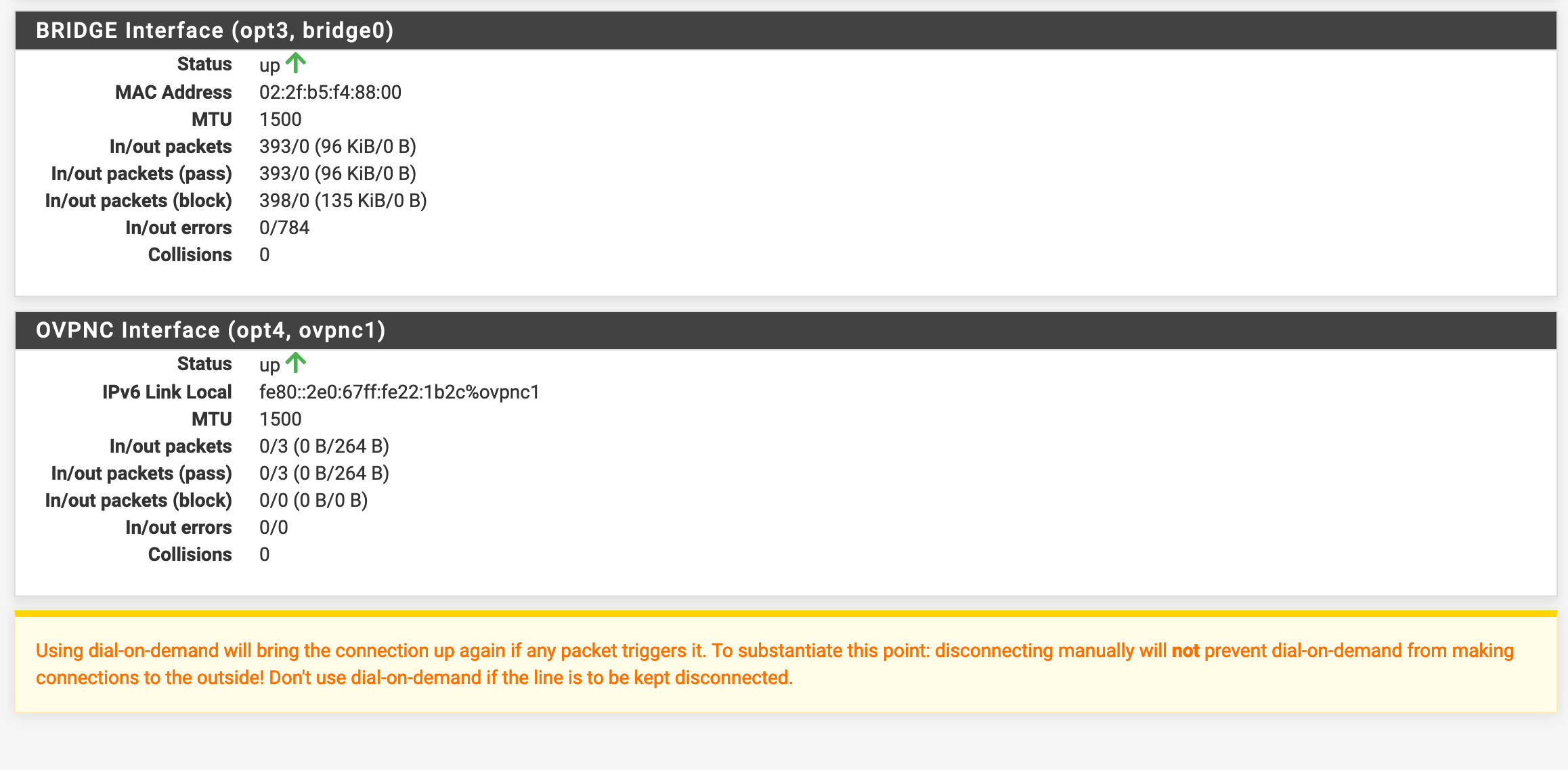

                        Status > Interfaces
                        Status > Gateways
                        Diagnostic > Routes
                        • F Offline
                          @viragomann
                          Changed it to Automatic and checked status of OpenVpn (refreshed). Still showing the same status.
                          Here's the rest of what you asked for.
                          Screen Shot 2024-05-06 at 1.35.42 PM.png Screen Shot 2024-05-06 at 1.35.48 PM.png Screen Shot 2024-05-06 at 1.35.53 PM.png Screen Shot 2024-05-06 at 1.36.10 PM.png Screen Shot 2024-05-06 at 1.36.27 PM.png Screen Shot 2024-05-06 at 1.36.40 PM.png

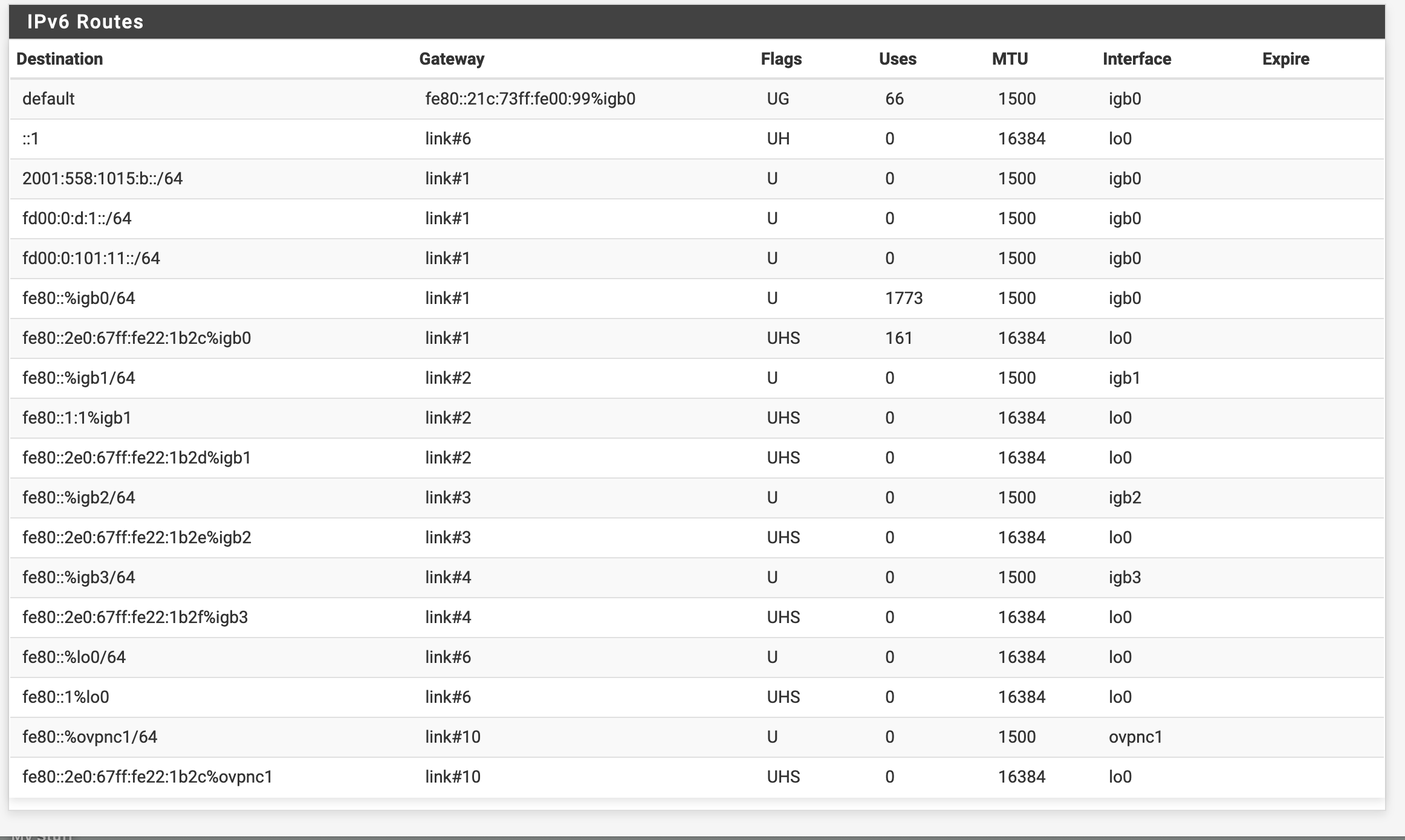

                          • V Offline
                            @fiyawall
                            You don't get an IPv4 address on WAN.
                            How you should get it, depends on your internet connection. Maybe you have to configure the modem as router and let it hand out an IP for pfSense or maybe you need use PPPoE.
                            But if you didn't make changes in the WAN settings of pfSense, I guess it should get an IP from the modem via DHCP.
                              johnpoz LAYER 8 Global Moderator @fiyawall
                              bought a new Arris model. It is a modem only, no wifi.
                              And did you call your isp to register it.. You can't just plug in a new modem to a cable isp and have it work.. There has to be registration, some times they support auto registration, where anywhere you go they redirect you to a registration page.
                              But if your trying to force everything out some vpn, that you can not connect to - that sort of registration is never going to work... But since you don't get an IP on your wan at all.. Nothing is going to work, normally if a cable modem can't link to the isp it hands out a 192.168.100.x to device connected to it.
                              I would suggest you call your isp. And make sure the internet actually works before you start wanting to setup a vpn connection
                                  I have internet.
                                  Not from what you posted you sure don't There is no way you have internet with a 0.0.0.0 IP address.
                                  Did you have some other computer connected this modem, and then connected pfsense? When you change the device connected to a cable modem, you need to power cycle the modem.
                                  What Arris modem do you have, like a S33 with a gig interface and 2.5ge interface - you can not use both at the same time..
