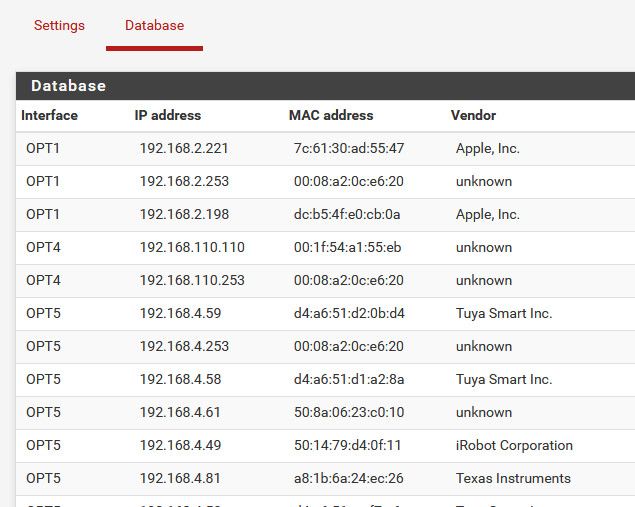

      Hello; I have a hand full of devices where I have set a static IP on the device it self; is there a way to see them all in pfSense? I checked the ARP table but i dont see them all in there.
      Even tough they are set static on the device, should I be added static entries in the DHCP section as well? Or is there a better way to see them all so that I know what IPs I have already given out.

        @iptvcld if you do not see them in the arp table, then they have not talked to pfsense in the last 20 minutes. The default arp cache is 20 minutes. Ping the device from pfsense - if it answers, ie its on. Even if its host firewall doesn't answer ping - it would be in your arp cache.
        Or go on the device and ping pfsense, or use the internet - if the internet works and its going through pfsense it would now be in your arp cache.

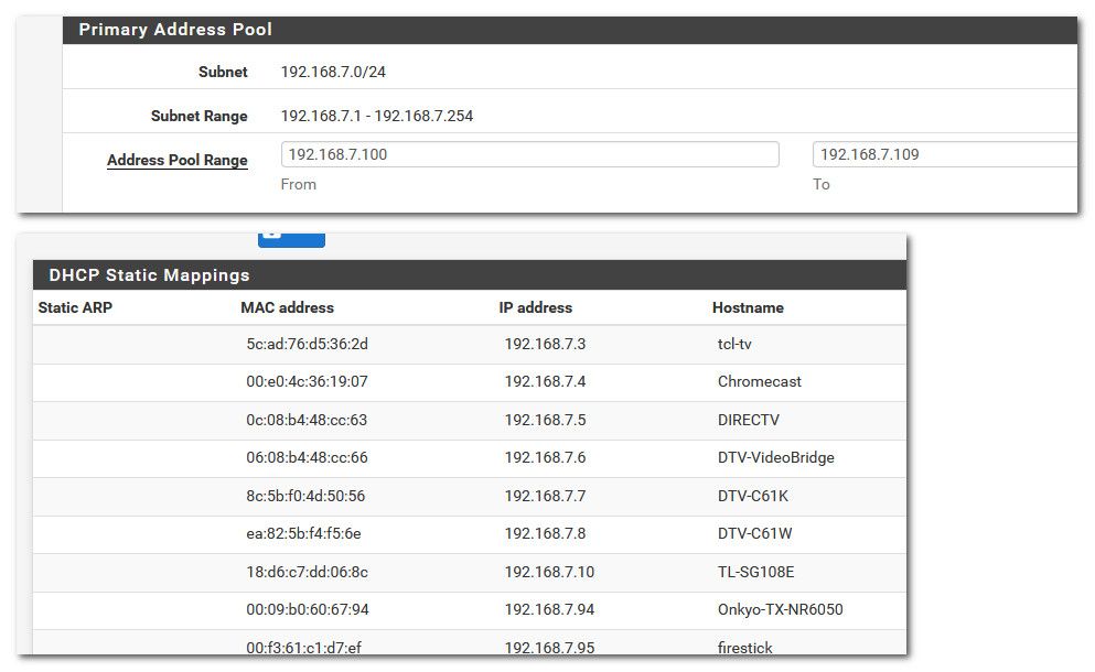

            @iptvcld you prob want to just set reservations for the device via dhcp so that it always gets that IP. And you will have a list of devices you have assigned that specific IP.
            Common practice is to make your dhcp pool say only .10 to .254 vs .1 to .254 then you can assign static devices from .1 to .9 as static on the device or via a reservation.
            Here is one of my networks
            Notice my pool is very small for dhcp leases only .100 to .109, I have them reservations (static mappings) for all my devices. This is because the only time I need a random dhcp address is when I first connect a new device to my network. Once it has gotten and IP and working. And I am going to leave it on my network, I change it over to a reservation (static mapping)
            Power cycle the device or release renew its dhcp on the device and validate it gets the new IP I assigned. Now even if that device is off I know not to reassign that IP to some other device.
