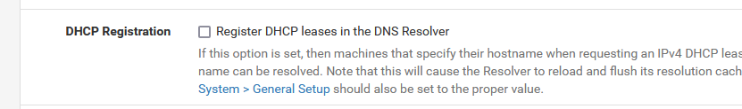

            Most probable cause : uncheck this one:
            as every DHCP lease will restart unbound when this option is checked.
              Thanks, I unchecked that option and will monitor the logs to see if that slows down the restarts.
                mwierowski @Gertjan
                @Gertjan, so far, since unchecking that option, I haven't seen a single restart of unbound. Hopefully, this will resolve the issue. Thanks again for your help.

                  I'd expect so. If you do need registration, the other option is to set a longer lease time. Clients normally renew their leases at 1/2 the lease duration. So a 1 hour lease with 30 devices would be an average of once per minute.
                  I believe Netgate is working on improving this when they are further along in transitioning to Kea DHCP.
