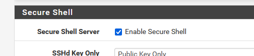

                        I created the file : /etc/sshd_extra and added :
                        #test line 1
                        #test line 2
                        TCPKeepAlive no
                        ClientAliveInterval 60
                        ClientAliveCountMax 5
                        Then I unchecked :
                        and saved, (the SSH connection stopped, that's normal) then checked it again, and Saved.
                        I entered SSH again, and :
                        [25.07-RC][root@pfSense.bhf.tld]/root: cat /etc/ssh/sshd_config
