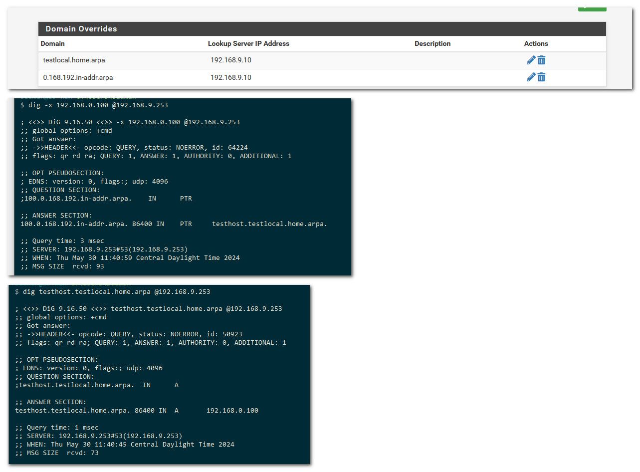

            So for example I setup NS on my nas dns.. for both the forward zone testlocal.home.arpa and the reverse zone 0.168.192.in-addr.arpa created some records in it.. And setup some domain overrides to forward to my nas at 192.168.9.10
