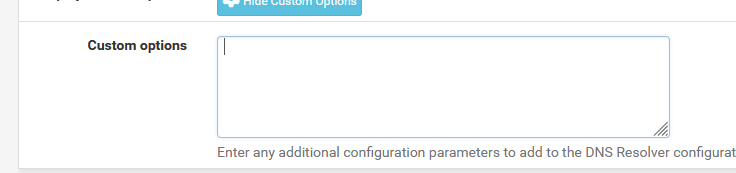

        If it is possible sing the GUI only, you should set up the GUI part of unbound as 'generic' as possible, and then build your own unbound config with this :
        You'll be needing the manual : unbound.conf
