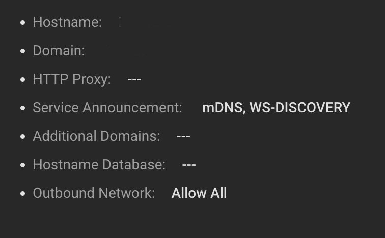

      My TrueNAS configuration never changed. But nonetheless, I recreated all my shares as multi-protocol SMB/NFS shares (I run a Ubuntu Server in VM that needed NFS to access those datapoints, run all my daemons). Here is my network config (hostname and domain redacted).

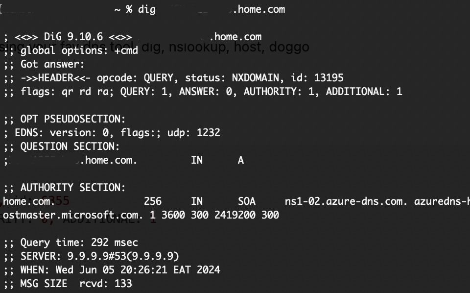

          @johnpoz Here's the result with dig: dig.jpg
            johnpoz LAYER 8 Global Moderator @n3IVI0
            @n3IVI0 well why would you think 9.9.9.9 know anything about your local resources.. Do you own home.com, somehow I find that unlikely..
