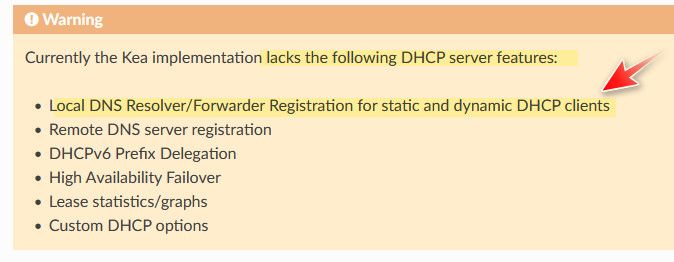

          Are you using isc or kea for dhcp - kea is not yet ready for prime time, it is preview and I know there is something about static reservations in the warnings about what features it does not support.
          I'm using KEA. All my DHCP reservations were working fine with it, until I added the DNS Resolver option for Plex.
          Your resources are actually local to pfsense, if you do any sort of domain override or forwarding that answers back with rfc1918, that would be a rebind and not presented to the client unless the domain being forwarded was set as private.
          Sure, but why would that interfere with the resolution of hostnames from DHCP reservations ?
            johnpoz LAYER 8 Global Moderator @madbrain
            @madbrain said in DNS rebinding breaks local DNS names:
            I'm using KEA.
            Go back to ISC...
            https://docs.netgate.com/pfsense/en/latest/releases/23-09.html#rn-23-09-kea
              madbrain @johnpoz
              @johnpoz
              Thanks. Going back to ISC fixed it.
