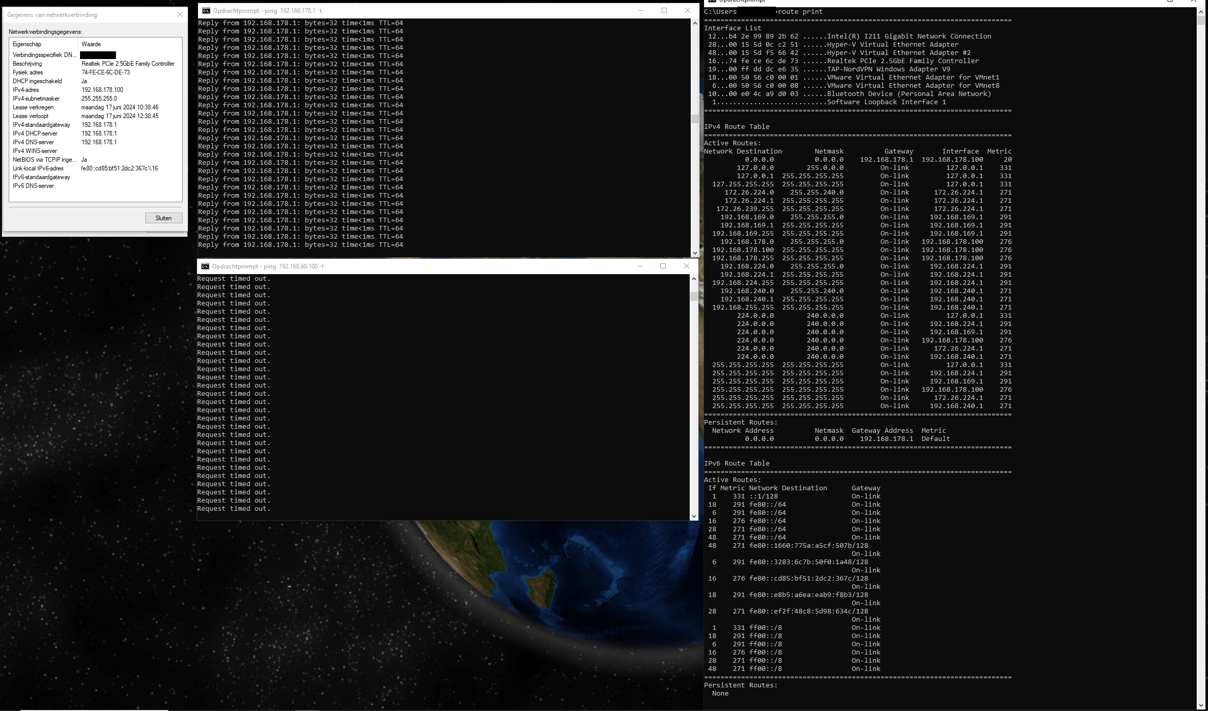

      The Problem:
      After configuring the setup, I tested connectivity by connecting two devices to different ports (Port 1 and Port 2). Both devices received IP addresses from the DHCP server (192.168.178.1) and can ping each other.
      When connecting one of the devices to Port 4 (the GUEST interface), it retrieves its DHCP address from the DHCP server (192.168.60.1) but the ping check fails. Both devices can ping their respective gateways.
      Troubleshooting Steps Taken:
      • Checked/Enabled ICMP-4 on both machines.
      • Connected both devices to BRIDGE (Port 1, 2, or 3) interface, ping check OK.
      • Connected one device to the BRIDGE interface and one device to the GUEST interface, ping check 'Request timed out.' Both devices can ping their respective gateways.
      • Deleted all rules and set allow-all rules on all interfaces (excluding WAN).
      • Disabled hardware checksum offloading as it can cause rare issues.
      Despite these efforts, the problem persists. My guess is that I am overlooking some setting that needs to be configured, but at this point, I don’t know where to look anymore. I'm looking for guidance on resolving this issue.
      I've included some screenshots for reference. Any help would be greatly appreciated.

        Are you sure the targets you are pinging between allow pings from outside their own subnet? Windows firewall will block that by default.
        Check the state table in Diag > States whist you're pinging. Make sure it's opening states on both interfaces.
          AG23 @stephenw10
          @stephenw10 Good question. I checked and found that ICMPv4-Out was indeed disabled for all profiles on both devices. I enabled ICMPv4 for both inbound and outbound traffic for all profiles public, private and domain in Windows for both devices. Unfortunately, this did not resolve the issue. Both devices still respond with 'Request Timed out'.
          I also checked the "Diag > States" page while pinging (see attachment for the results). During the ping command, I observed that the first number in the "Packets" column increased with pings from the 192.168.178.100 subnet to 192.168.60.101, and the second number increased with pings from the device in the 192.168.60.101 subnet to 192.168.178.100.
            Windows uses the ID for all ping traffic (1). So if you send pings from 192.168.60.101 to 192.168.178.100, whilst a ping is already running the other way, it will use the existing open states. Hence you see that as replies.
            It's opening states correctly there though. It looks like the hosts are still just not replying.
            You could confirm that with a packet capture on the guest interface to be sure the ping requests are leaving there towards the correct MAC.
              AG23 @stephenw10
              @stephenw10 Based on your response, It got me thinking the issue might be with the ping requests and how the Windows machines respond to them rather than a pfsense network configuration problem. To be sure, I ran a simple web server on the machine connected to the GUEST interface and successfully connected to it from the machine on the LAN interface.
              I believe that using only a ping as a test mechanism to verify the connection between the two subnets led me in the wrong direction. Can I conclude that being able to connect to the web server on port 5000 indicates that pfSense is working correctly?
              If so, I will proceed with configuring the router, assuming that a ping is not a reliable test method, before integrating it into the network.
              (favicon.ico 404 error is expected because it doesn't have a favicon.ico)
              HLPPCH 1 Reply Last reply Reply Quote 0
                Yup seems good.
                Something is rejecting the pings on those hosts.
