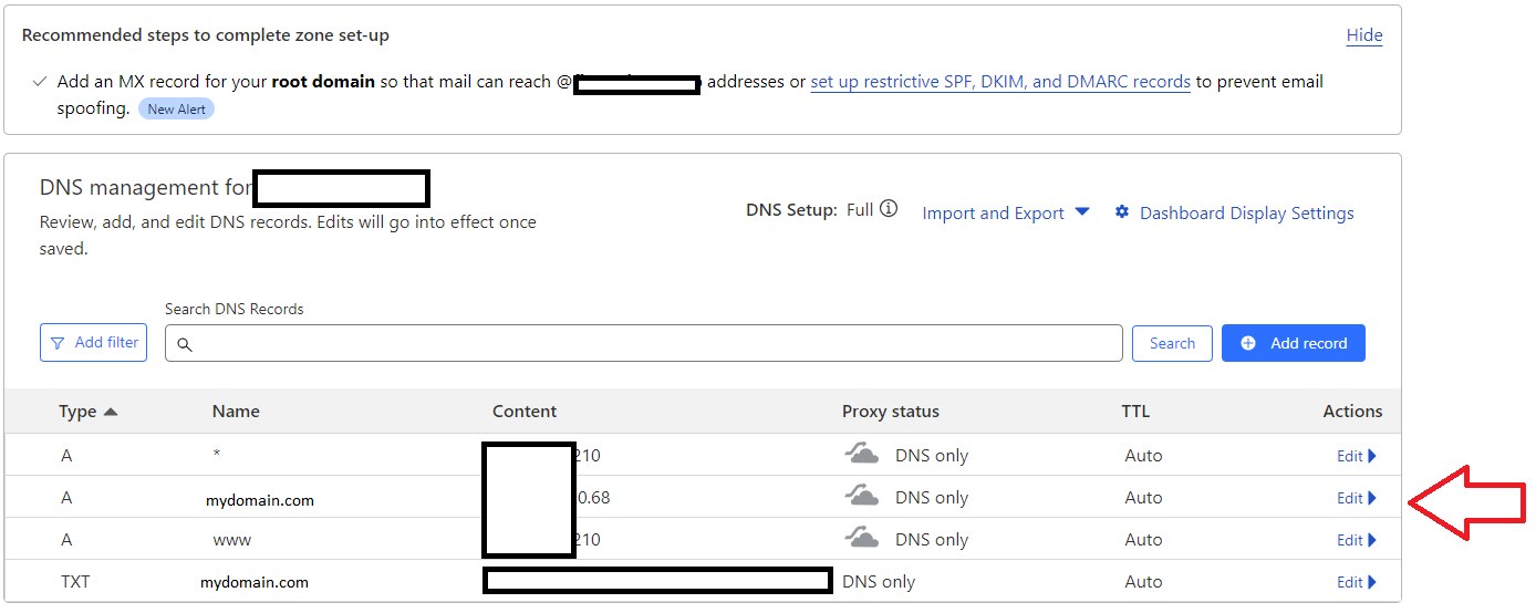

      My config:
      It updates only this one, with the red arrow
      I need it to update all of the three upper records, how do I do that?
      I guess "@" might be the wrong character to use here?

        paoloposo @Flemmingss
        @Flemmingss You can either duplicate the DDNS entry in pfSense such that there is one for every A record you want to change. Or you could keep changing only one of the A records and use CNAMES for the others.
