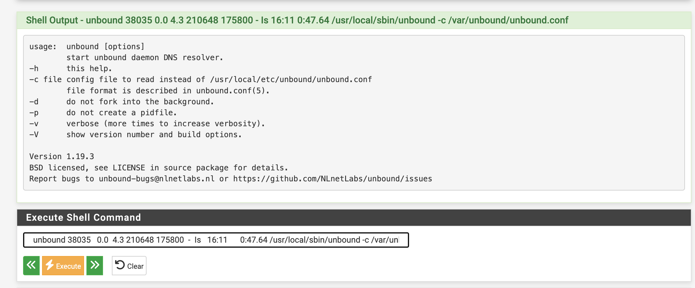

            unbound 38035 0.0 4.3 210648 175800 - Is 16:11 0:47.64 /usr/local/sbin/unbound -c /var/unbound/unbound.conf
            I get this when putting in line 2
            patient0P GertjanG 2 Replies Last reply Reply Quote 0
            • patient0P Online
              patient0 @KKIT
              @KKIT I'm sorry I wasn't clear: you enter only the first line ps aux | fgrep -i unbound and the other lines are the result of that command in my case.
                Gertjan @KKIT
                @KKIT
                Nooooo.
                Never - ever use the GUI Diagnostics > Command Prompt
                GUI command line is ... bad, or worse.
                Use SSH.
                K 1 Reply Last reply Reply Quote 1
