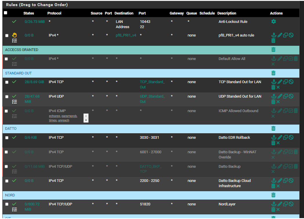

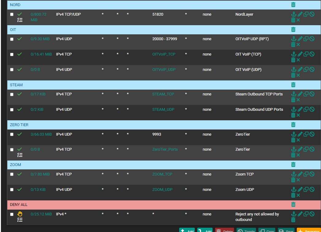

@wwdot_computers post a screenshot of your LAN rules.

@wwdot_computers So, your "_standard_out" aliases or another rule needs to allow the port used. If you don't know the port you can enable that "default allow all" rule up top to allow all outbound.
Edit: or allow the service's IP(s) as John described, using any port.

@wwdot_computers but that is outbound traffic - you would have to adjust your rules to allow for the traffic.. So you see that blocked.. By default default deny is logged.. So if your rules do not allow these to talk to something in the cloud, ie the internet then one of your rules is not allowing it.
Did you inherit this set of rules? I would assume someone that created all those would understand how to allow something else..

Unless you have turned off default deny logging that is logged, and your last reject rule is set to log - so if pfsense blocked something from it would be logged
