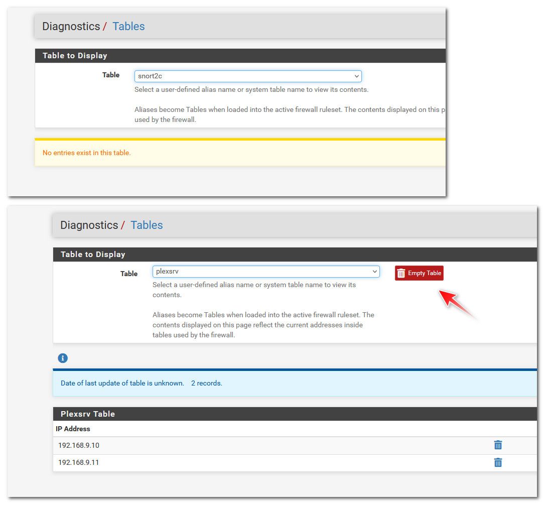

                @wwdot_computers I believe you go to the tables section call up the table and click the empty button.
                I don't use snort not 100% but any table should be listed under diag / tables - and there is an empty button.
                edit: believe this is the table - mine is empty so no clear button, but if you have stuff in a table there should be the clear button

                      Looking at the pictures you inserted when we were talking about Snort. Do I need to empty the plex table too if it is there?
                        johnpoz LAYER 8 Global Moderator @wwdot_computers
                        @wwdot_computers no that was just a table of mine to show the clear button
