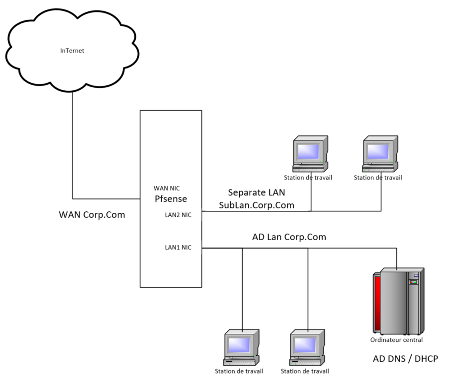

      I have the following setting :
      pfsense dns resolver is active and handles split DNS for corp.com between internet and corporate AD.
      IE there is a domain override rule in dns resolver corp.com <dnsserver IP on AD LAN>
      I am setting up a separate LAN on a separate NIC. I use pfsense DHCP to provide LAN info to this net.
      Is there a way to split dns so that sublan.corp.com can be a delegated domain in AD DNS servers and have pfsense provide answers to dns queries using dhcp host names on LAN2 NIC.
      I have tried to domain override sublan.corp.com to pfsense IP (both on LAN1 and LAN2 ip), but it does not work.

        Who is going to be authoritative if you will for these sublan.corp.com records. Is pfsense going to hold the records you want to resolve or is your AD dns?
        If you want your AD dns to answer for host.sublan.corp.com domain this would just be another domain override pointing to the same AD NSers.. You will also want to mark this domain as private as well - because any time you forward and the answer is rfc1918 that would be a forward.
        You could also just create records in unbound for host.sublan.corp.com if you want them to resolve..
          I intend to use pfsense as authoritative for sublan.corp.com.
          I want AD Dns to use sublan as a stub or copy of the domain infos provided by pfsense for the sublan
          Since I use pfsense DHCP server on sublan, I would like that dhcp hosts on SUBLAN can be looked up from the AD DNS.
          Is this possible?

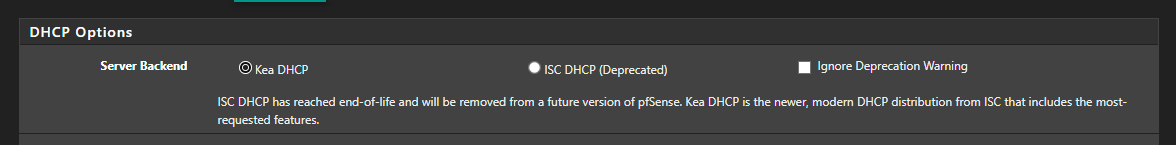

              If I nslookup and set pfsense as server, it resolves google.com and corp.com hosts, but it does not resolve any sublan.corp.com host. Did I miss an important setting in my kea dhcp?
              (I did not find the update dns for each dhcp lease checkbox, in the settings, so I can't confirm it is checked as it should)

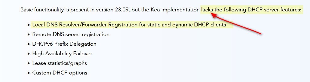

                kea does not support static or dhcp reservations as of yet.. If that is how your wanting to add hosts.. Kea is preview version - there was blog and release notes on what features are missing, which is most of them.. Kea is only really viable if you just want to hand out IPs and not doing anything with them or any sort of dhcp options.

                  I wish this was as clearer in pfsense settings:
                  where it looks to me that KEA is the way to go NOW.
                  Is the "blog and release notes", your refer to : Netgate Adds Kea DHCP to pfSense Plus Software Version 23.09 ?

                    johnpoz LAYER 8 Global Moderator @sbs
                    @sbs said in How to setup split DNS & SubDomain in pfsense DNS forwarder:
                    It looks like the dhcp clients registration in the resolver should be working.
                    Where would you have gotten that idea?
                    Yes the notification of eol could of been worded better, nobody is disagreeing with that.. But then again reading the release notes are something you should really do when upgrading.
