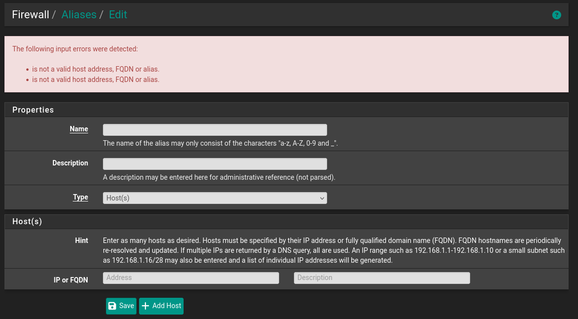

    Alias error
    27 Posts 7 Posters 7.3k Views 7 Watching
      cjohnson
      I'm running the latest 2.7.2.
      Whenever I attempt to add an alias (Firewall > Aliases > Edit) with a Type of "Hosts(s)" in the webUI utilizing a single host IP, CIDR, or range of IPs; I consistently get.....
      The following input errors were detected:
         is not a valid host address, FQDN or alias.
      Isn't the "is not a valid...." part of that usually prepended with an IP/IPs?
      A few simple examples I've tried..
      "192.200.0.210"
      "192.200.0.210/32"
      "192.200.0.210-192.200.0.230"
      These IPs are alive and well on my network.
      What am I doing wrong here?
      • patient0P Online
        patient0 @cjohnson
        @cjohnson That indeed looks alright. I assume you don't add the quotes to the IP, yes?
        What is a bit odd it that if I enter an IP with let's say the quotes it tells me where the error is, like:
            "192.200.0.210" is not a valid host address, FQDN or alias.
        Have you by any chance added an empty "IP or FQDN" line with a space in it? If I do that I see:

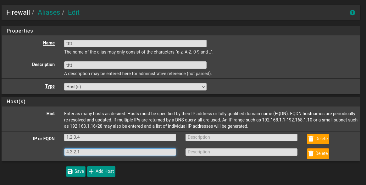

          cjohnson @patient0
          @patient0 said in Alias error:
          Correct.
          Firewall > Aliases > (IP tab is selected) Click the "Add" button.
          Populate the "Name" Field with this exactly --> TestALIAS
          Populate the "Description" Field with this exactly --> testDESCRIPTION
          Change the "Type" drop-down to this exactly --> Host(s)
          Within the row labelled "IP or FQDN", populate the 1st box with this exactly --> 10.200.0.210
          (The 1st box contains exactly twelve characters, I've ensure there are no leading, or trailing spaces)
          Within the row labelled "IP or FQDN", populate the 2nd box with this exactly --> testHOSTIPdesc
          Final Step: Click the "Save" button.
          Then I see this.......
          I've also tried this using "Bulk Import Network Aliases" per the Netgate Docs site.
          Going that route creates the Alias for me however, with zero IPs contained within it.

                johnpoz LAYER 8 Global Moderator @cjohnson
                @cjohnson not sure what your wanting to accomplish but in your second shot I don't see an IP..
                As mentioned is something removing that when you go to click save?
                I have no issue creating such an alias.
                  cjohnson @johnpoz
                  @johnpoz said in Alias error:
                  I'm merely attempting to add an alias.
                  What you've pointed out there is exactly the problem I'm chasing.
                  The only action taken in between the point in time where I populated the fields as shown within the 1st screenshot, and the point in time where I grabbed the second screenshot was....
                  So, timeline-wise...
                  ---All fields populated with "TestALIAS" and IPs etc...then.....
                  "Final Step: Click the "Save" button.
                  Then I see this......."
                  ---Second Screenshot Taken--
                  In short.... I fill all of the fields correctly and hit "Save".
                  Somehow, someway; for whatever the reason... something happens in between those two actions wherein my form data doesn't make it's way to the pfSense box, or the form data doesn't get parsed correctly...or...maybe getting munged in transit.....something like that. I don't know.
                  At this point I'm not sure what to do next to figure out where things are breaking down.

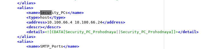

                          @cjohnson Can you create any other type of aliases? If yes, I'd try create one of another type, save it, edit and change to type host.
                          Or if you got another pfSense instance create it/them there, export them (via Backup&Diag) and import only the aliases (Restore > Aliases).
                          Important to note is that the aliases import replaces all existing alias with the once in the file. It does not merge with existing aliases!
                          If you feel adventures (is it a PROD system?) and know vi you can edit the config XML directly using viconfig (see doc here) on the command line. This uses the vi editor to edit the config in-place.
                          The structure is:
                          <aliases>
                          	<alias>
                          		<name>testALIAS</name>
                          		<type>host</type>
                          		<address>10.200.0.210</address>
                          		<descr><![CDATA[testDESCRIPTION]]></descr>
                          		<detail><![CDATA[testHOSTIPdescription]]></detail>
                          	</alias>
                          </aliases>

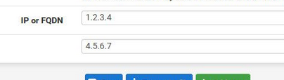

                              cjohnson @cjohnson
                              OK.This is strange.
                              I can sucessfully use the "Import" button (which takes me to the "Bulk Import" page) on the main "Aliases" page to then create the alias with a range of IPs (using the "Aliases to Import" box on the subsequent page) how I want them.
                              If I attempt to import an exported alias XML from another box where I've created the alias how I attempted to do so to begin with, it doesn't quite work correctly.
                              If I then attempt to edit what I have there....
                              Any attempts to populate one or more of the address boxes (left column) there then save it, I get a similar looking "is not a valid host address" error as before. There's a very slight difference this time though. If i populate all three of those "testX" rows that you see in that screenshot, then try to save it... the error shows like this
                              So, there's for sure something jacked up with the parsing of the data once it gets into the box.
                              This rules out the "is my data getting munged before it even gets to the box" question.

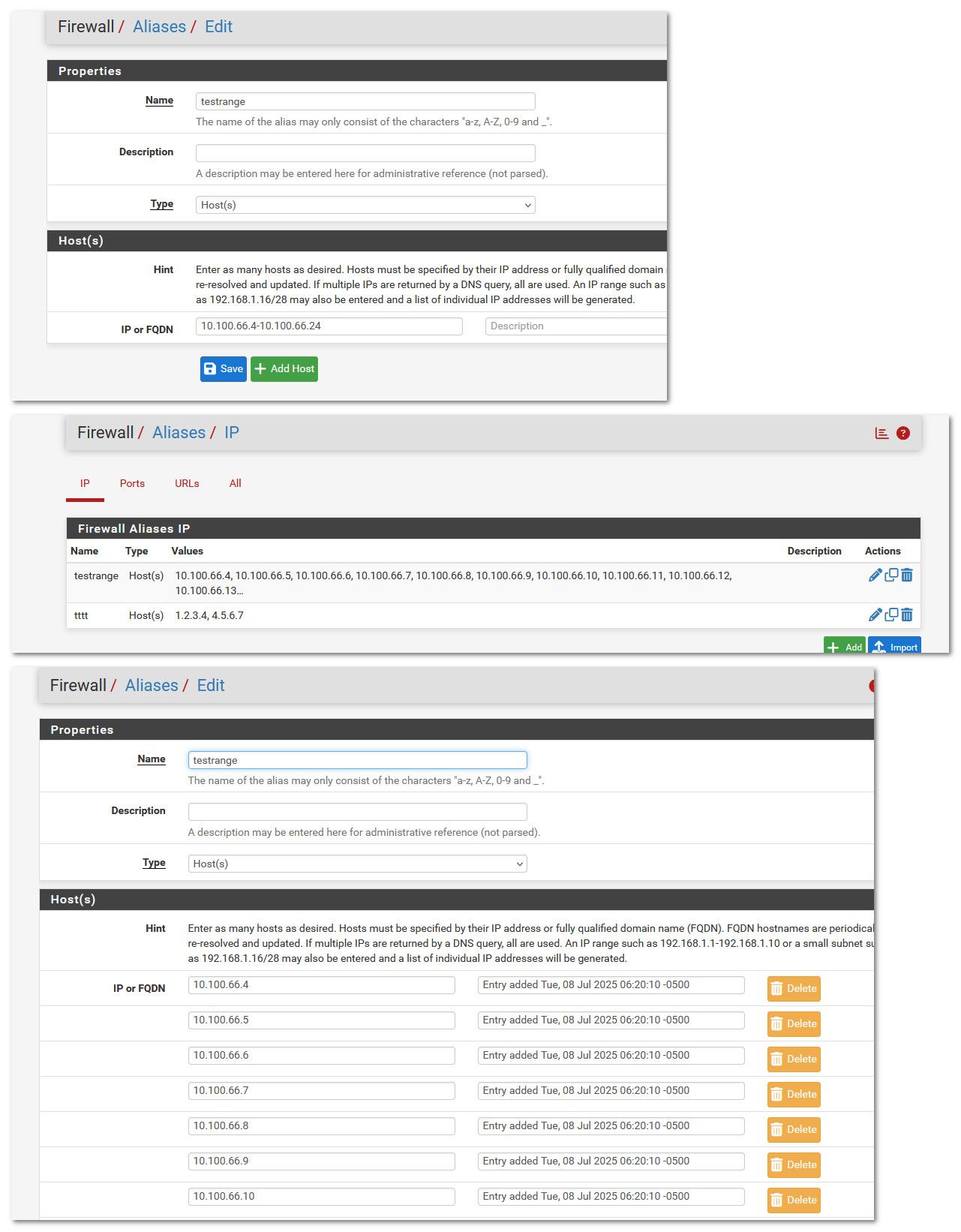

                                Anry @cjohnson
                                Hello.
                                After updating the system to version 2.8.0-RELEASE (amd64)
                                built on Thu May 22 2:12:00 EEST 2025
                                FreeBSD 15.0-CURRENT
                                a similar problem arose.
                                Are there any solutions?
                                  johnpoz LAYER 8 Global Moderator @Anry
                                  @Anry yeah use an actual valid FQDN or IP.. Like it says right there in the HINT in your screenshot.
                                  test1 is not a fqdn, something like test1.home.arpa or test.domain.tld would be a fqdn - this fqdn has to be resolvable by pfsense.
                                    Anry @johnpoz

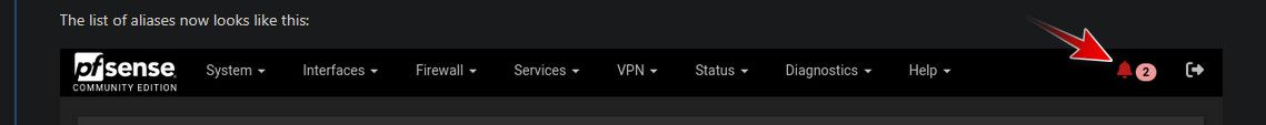

                                    When trying to create a new alias
                                    I receive this message
                                    The list of aliases now looks like this:
                                    The contents of aliases are not displayed.
                                    But they should be.

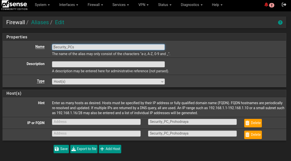

                                    When editing an existing alias, list items are not displayed
                                    There is such an alias with a list of hosts in the configuration

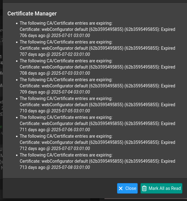

                                          Anry @johnpoz
                                          @johnpoz
                                          I am attaching a screenshot.

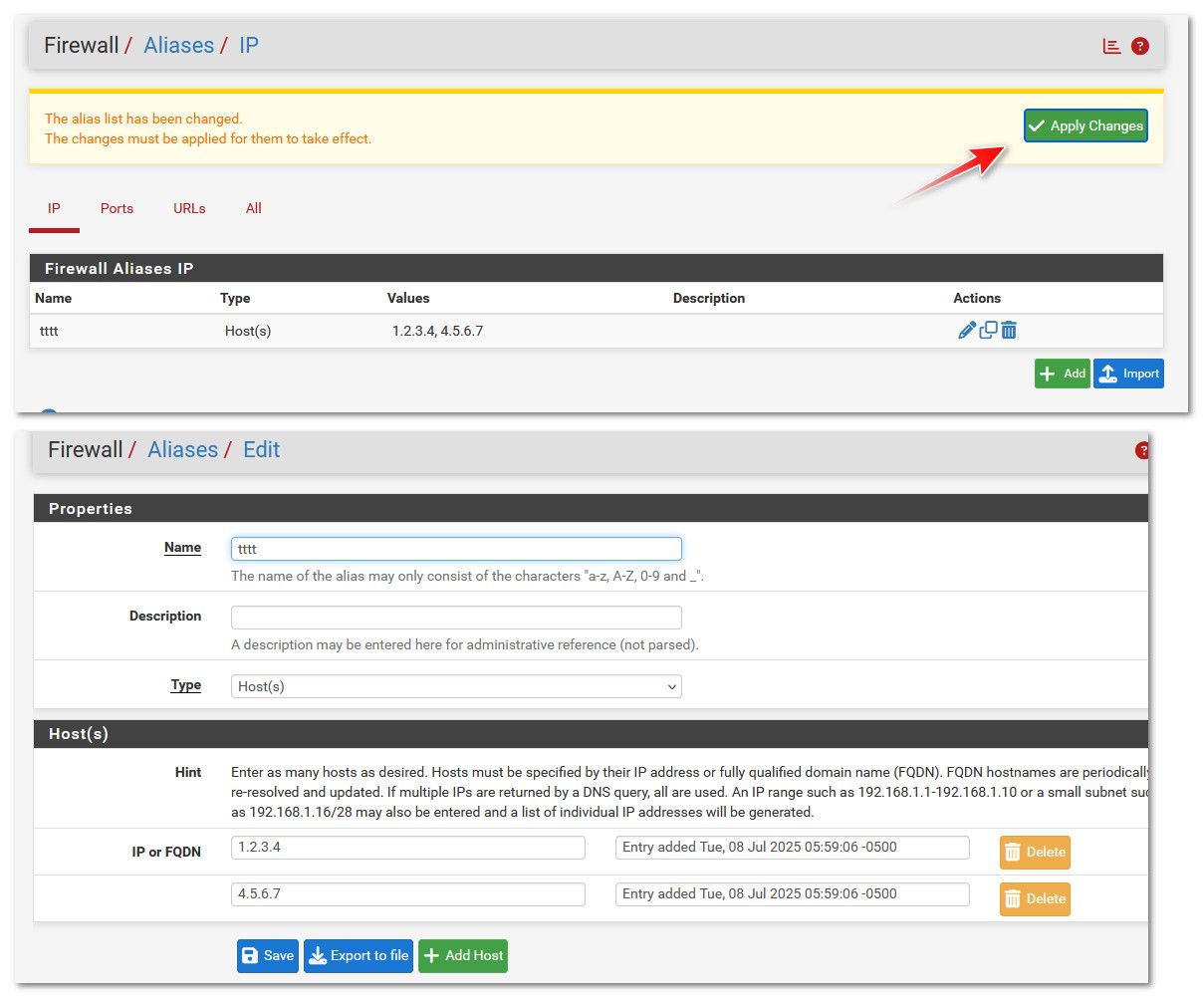

                                            @Anry well I would prob fix that - you have never renewed your gui cert? But that has nothing to do with the problem.
                                            I am unable to duplicate your problem - but a complete reinstall seems like a sledge hammer to kill a fly.
                                            I would export your aliases xml.. just so you have a copy of what you had.
                                            Then delete them all.. And try from a clean slate for aliases.. Making sure after you delete them all that your export of xml is clean.
                                            I even fired up my copy of 2.8 - and aliases working fine.
