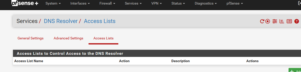

      I lost DNS resolution after upgrading to 24.03 on my Netgate 4200. I had to add an ACL to allow requests from my internal network. This was not required prior.

        So, I'll testing right now these simple ACL settings :
        Yep : none.

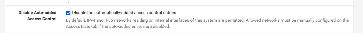

          @bchipman unless you have disabled creation of the auto acls, any networks that are directly attached would be in your auto acls.
          I personally disable them, and create my own - I want to know exactly what the acls are, and might create specific ones that do different stuff.

            Where is that option?
            I don't think I have changed it.

              Ok, I found it and that option was not selected.

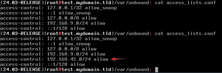

                Here fired up one of my vms.. You can see the auto acls in the config.
                Then I added a new network via a vlan, enabled it gave it an IP 192.168.42.1/24
                Restarted unbound and you see it updated the access list to include my new 192.168.42 network
