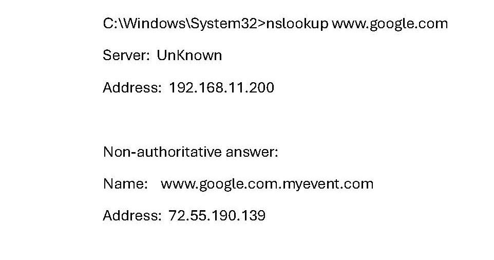

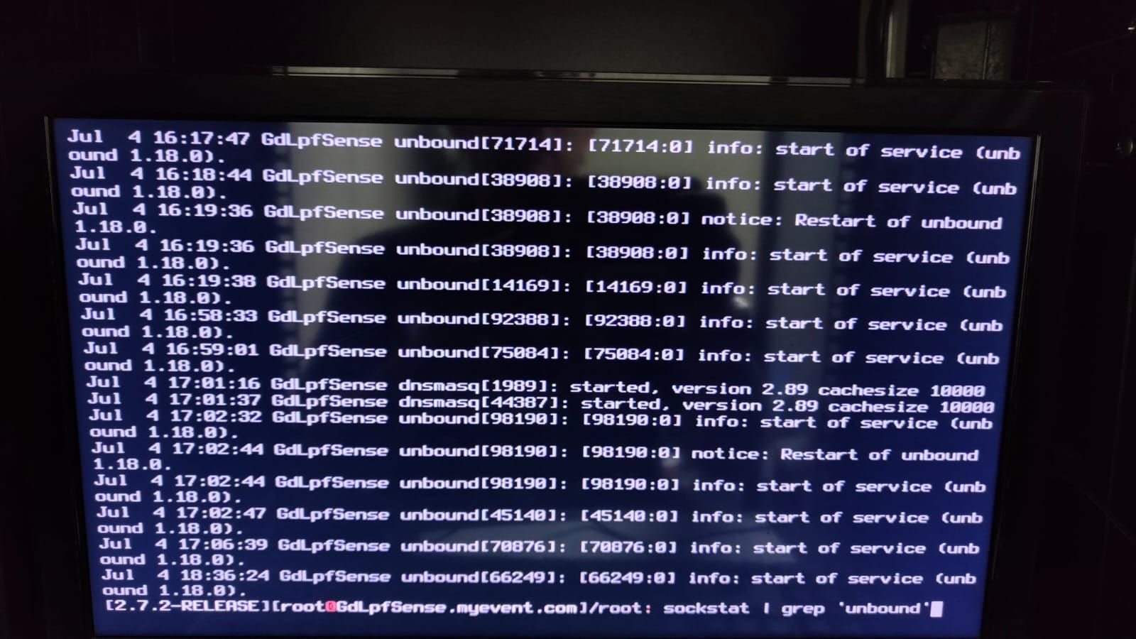

                Davide gdl @Davide gdl
                @Davide-gdl good morning again here all the procedure you requested to see.
                thanks again
                  Gertjan @Davide gdl
                  @Davide-gdl
                  Ok, all that looks fine.
                  Unbound listens on all interface.
                  For some reason, your pfSense LAN IP is 192.168.11.200, somewhere in the middle.

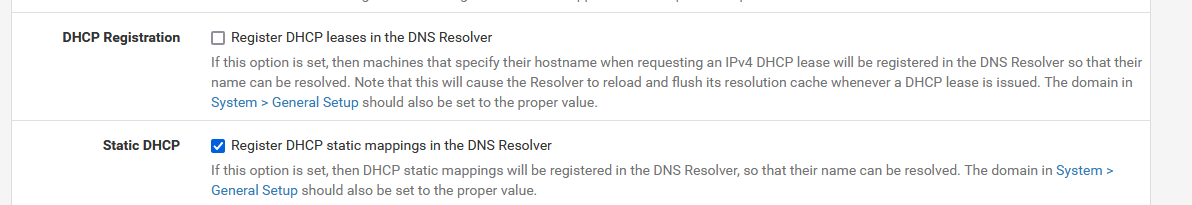

                  Do you have this option selected :
                  DHCP Registration ?
                  If so, be aware : on every incoming DHCP lease, or renewal, unbound gets restarted.
                  Example : if you use a Wifi device, and this is at the border of what is reachable by wifi, they will loose, and regain a Wifi connection very often. No a big deal, but now you know how to interpret this information : a DHCP request is send by the device and handled by pfSense ...
                  .... and unbound gets restarted on every DHCP transaction, for every interface.
                  Some more info : during unbound restart, which can take some seconds, or way more if you uses DNSBL like pfBlockerng, this can takes tens of seconds (are we getting close now ?). During this time, DNS is out. Not a big deal neither, but for some reason this gets interpreted as "Internet is slow or doesn't work", or, in reality, its just DNS (unbound on pfSense) that doesn't work for a moment.
                  So : uncheck that option. Save, reload, and solved.
                  If you want to register devices in your DNS, you can still do so.
                  Give your printers, TV, NAS etc etc a "static MAC DHCP lease". Do this ones, and you'll be good.
                  Normally, I add a "static MAC DHCP lease" for every device I own, and every device that I know of (familly etc).
                    Davide gdl @Gertjan
                    @Gertjan hello,
                    no this option is not selected.
                    and also the option disappear once you pass at the suggested KeaDHP instead to use ISC DHCP.
                    I actually tried both of the option in the past days, with no results. I mean, no changes in the behaviour. in any server backend I place pfsense.
                    I just turned back to ISC DHCP (mentioned deprecated) but nothing change,
                    About adding MAC to every user it will result bit difficult due the amount of users.
                    I will try to play again to see if I can sort out.
                    Thanks

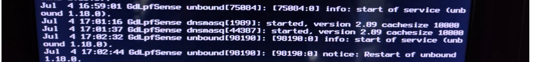

                      Gertjan @Davide gdl
                      @Davide-gdl said in DNS on DHCP slow first page loading:
                      Then there is a problem.
                      Who or what is restarting unbound/the resolver that much ?
                      Another reason might be : one of your interfaces get a repeating down and up link event. That will rstart many of the pfSense process, unbound included.
                      A solution for this is : every pfSEnse interface (except WAN) connects to a switch. Your LAN devices connect to these switches, not pfSense directly.
                      And just now I saw something else, something quiet uncommon and probably very wrong :
                      Are yo that expert that uses dnsmasq and unbound at the same time ?
                      This :
                      tells me that unbound grabs on on all the interfaces port number 53.
                      Now, a server - one server - can bind to 'a port', like only one person can pick up a phone. There can't be another server binding to the same interface same port same protocol.
                      Why is your dnsmasq (DNS Forwarder) active ? You can use the resolver, or the forwarder (dnsmasq), not both.
                        Davide gdl @Gertjan
                        @Gertjan good morning again,
                        who..... here I am. In the sevices, I restarted several time (manual says clear the DNS cache) to unserstand if something was changing.. nothing.
                        I did swop several time from DNS resolver to DNS forwarder, but NEVER I left them work at same time.
                        In this moment I went back to the origin. DNS resolver and DNS forwrder off.
                        No I'm not, and I didn't understood this question. Can you explain me better? ot tell me which are the actions I need to take to verify or fix it?
                        Thanks again.
                          Gertjan @Davide gdl
                          Noop.
                          It is possible thought. Its important to chose for example LAN and OPT2 as the interfaces to be served by unbound and OPT2 and OPT3 by dnsmasq.
                          But I never found a usage case where this was needed (for me).
