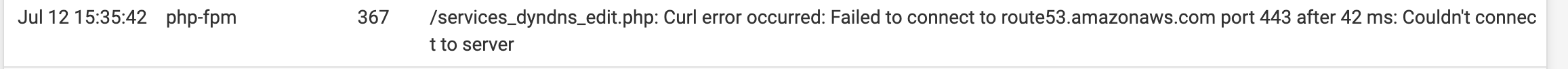

      My new ISP requires 6rd Tunnel for IPv6 and it is up and running correctly but when I try to update Route 53 with Dynamic DNS it fails to connect. I have no issues with the IPv4 update. The IPv6 update was working correctly before using 6rd Tunnel. Any ideas?Screenshot 2024-07-12 at 1.40.29 PM.png

        After more troubleshooting, I can confirm the XML from the verbose log used for the upsert is correct and works as except using Postman. Not sure why it's timing out.

                -Yes and here is the output. On a successful update both "/services_dyndns_edit.php: Response Header:" and "/services_dyndns_edit.php: Response Data:" have values but here they are blank.
                After more testing, if I monitor another interface with IPv6 it works fine. I believe Curl might be having issues with WAN's address due to it ending in double colons. It looks something like "2602:xx:xxx:xxxx::" but the other interface is "2602:xx:xxx:xxxx::1" and it works. The reason I believe it is Curl and not AWS API since it is working work the XML from the log within Postman. I have also observed this behavior on another PfSense installation with the same ISP. With a WAN address ending in :: as in "2602:xx:xxx:xxxx::"the update fails as well.
