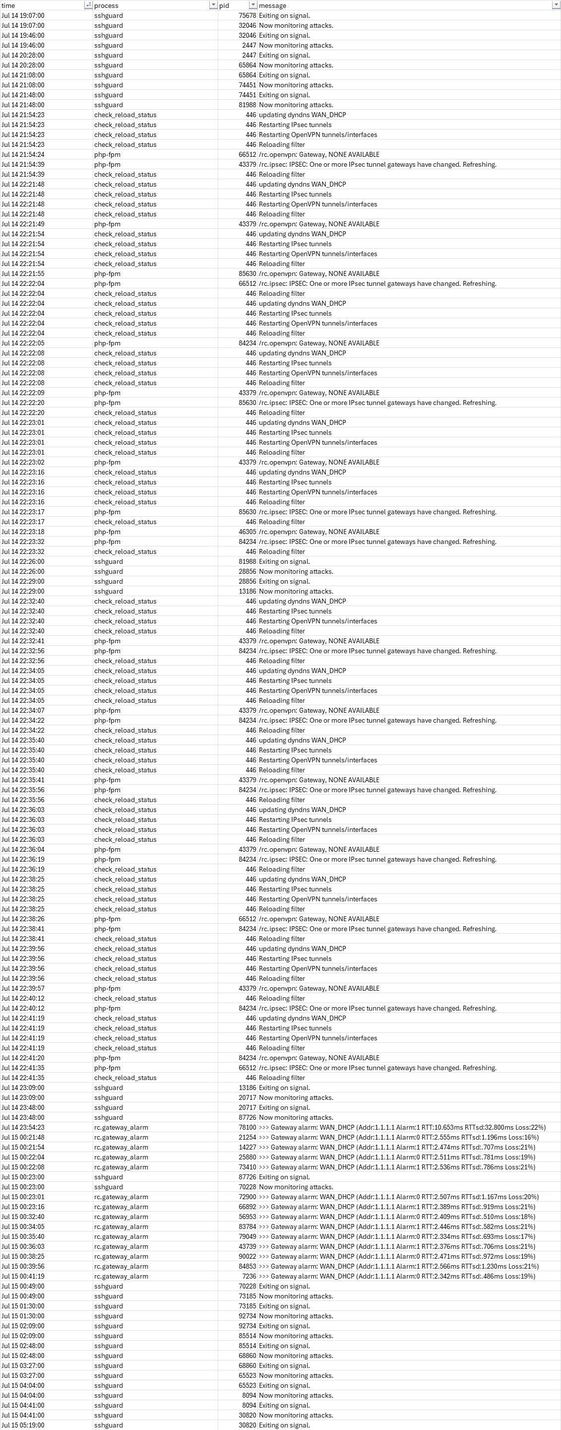

I don't see any errors in the logs , the bit that looks strange to me is circled with red , note that we have two connections one is ike v1 the other is ike v2 with different partners.
The part i circled , it;s because the description doesn't match the configuration page and also the id says con2 instead of con2_1 or something like that -
