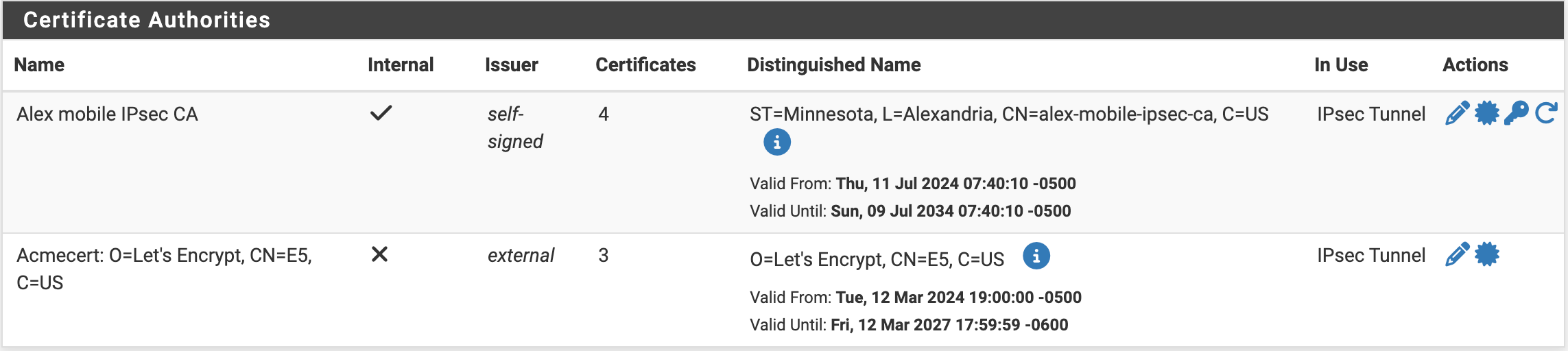

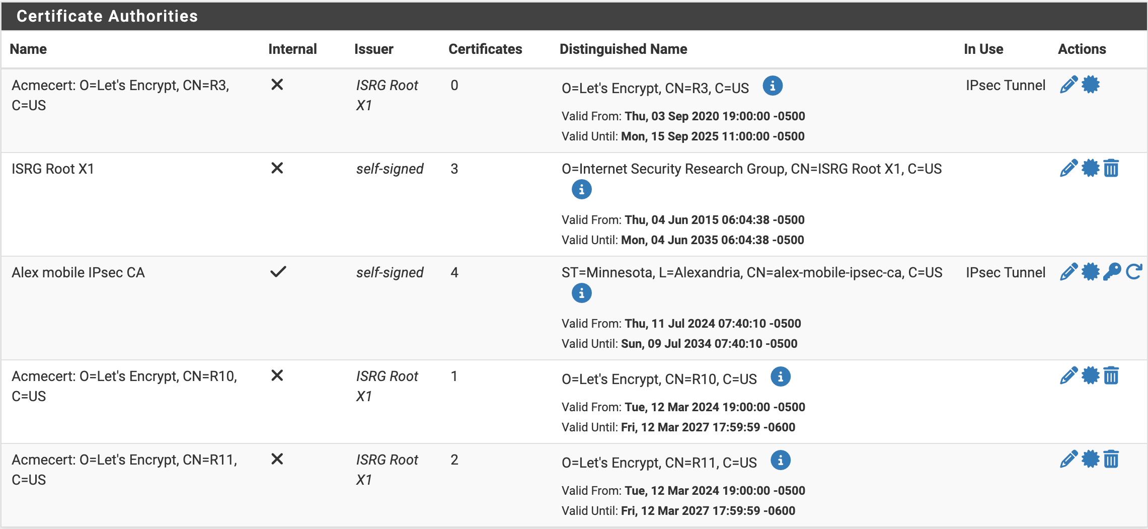

      I did record the following before deleting the manually imported ISRG Root X1 CA cert:
      This is the current state:
      So my question is, if I am correct, how do I exorcise any remnants of that ISRG Root X1 cert I manually added and then later deleted????
