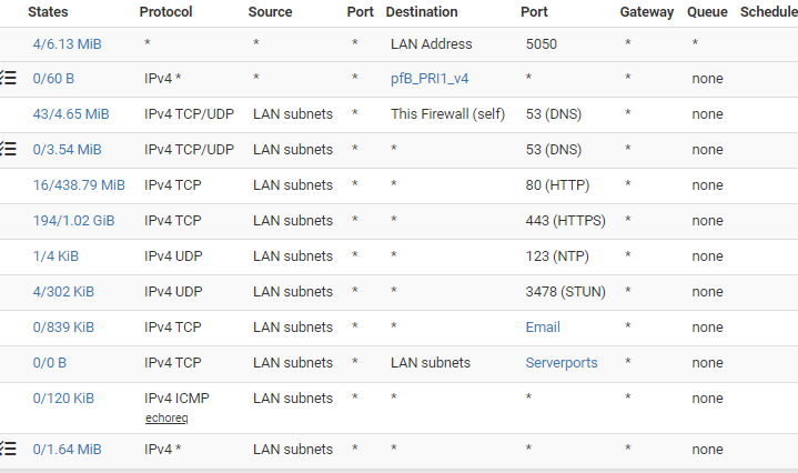

                  Samuelking @viragomann

                    • V Offline
                      viragomann @Samuelking
                      @Samuelking
                      Without showing the rule action on the left, the rules screenshot is pretty useless.
                      Presumed the last rule is a block rule, because you created pass rules for certain services, access to port 846 would not be allowed by your rule set.
                      johnpozJ S 2 Replies Last reply Reply Quote 1
                        johnpoz LAYER 8 Global Moderator @viragomann
                        Yeah without seeing what those are allow/deny they are not all that helpful..
                        That 2nd rule to pfb_pri would assume is a block, and that for sure could be blocking access, it has been evaluated some.
                        And as @viragomann mentions that last rule also assuming its a block would not allow access to some port 846 because it doesn't seem like you allow that port above it.
                        When you post rules, you should include the top part showing what actual interface of pfsense its on.. And we need to see if the rules are allow, deny, reject, etc. Yeah we would assume this is on the lan.. But then the any any rules make no sense unless this is a transit network.. How would you have any source IPs coming into lan that were not lan net? So rules with any as source don't make a lot of sense.
                        Also do you have any floating rules?
                          @viragomann @johnpoz all rules are allowed except dns 2nd rule and pfblockerng which is reject, also i have tried to clear all rules to default but same issue
                          no floating rules
                          I changed to bydefault rules prior to this configuration
                          this is my home network now i am away my network..
                          please suggest basic standard rules so that i can access webserver from pfsense
