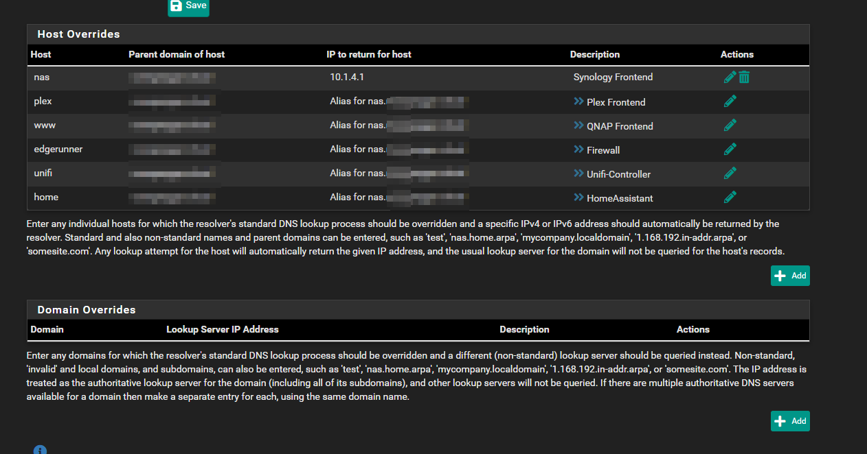

      My DNS shows a wrong lookup for the internal address and I can't find where to delete it.
      The address I want to resolve is as follows: edgerunner.xxx.xxx
      My DNS configuration looks like this:

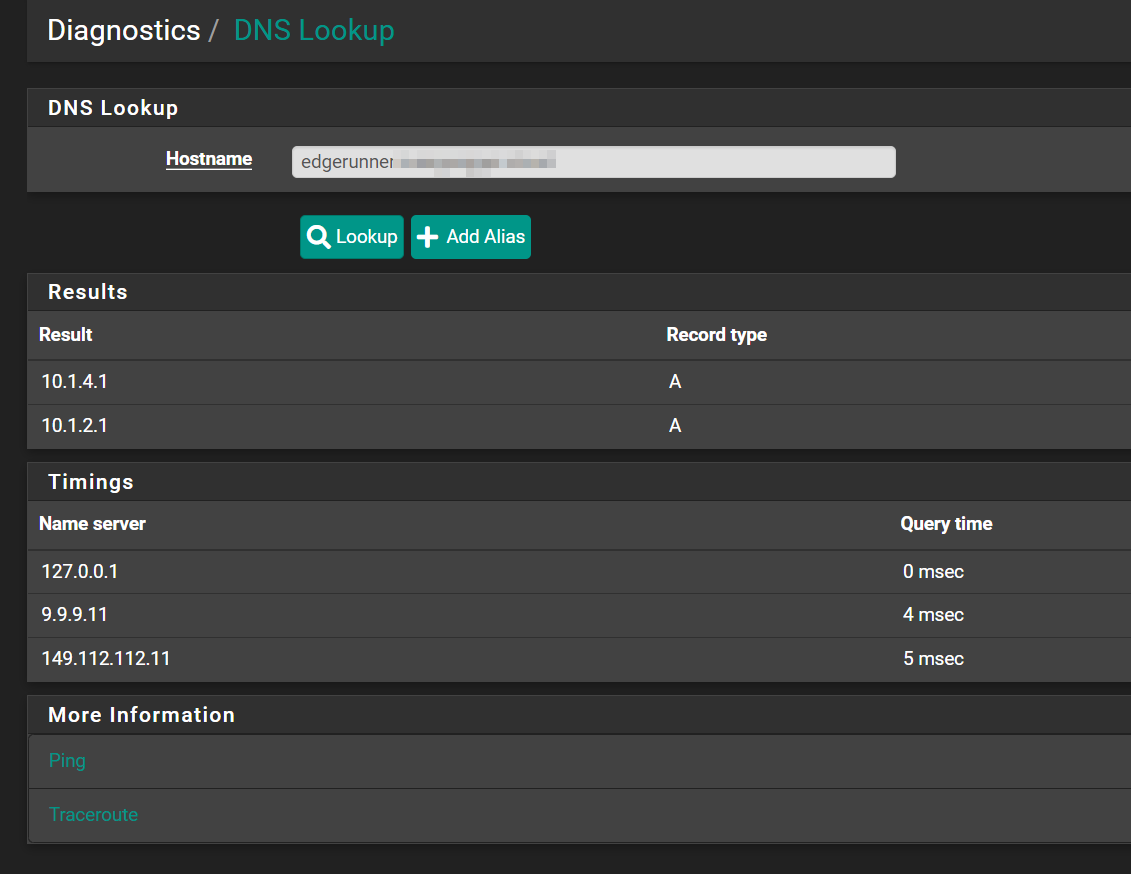

      And the DNS on my firewall shows the following entries:
      10.1.4.1 (that would be correct)
      10.1.2.1 (that would be incorrect)
      This of course leads to very long loading times as it first queries the wrong one. Now I wanted to delete the wrong entry. I have done the following:

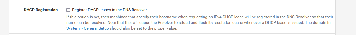

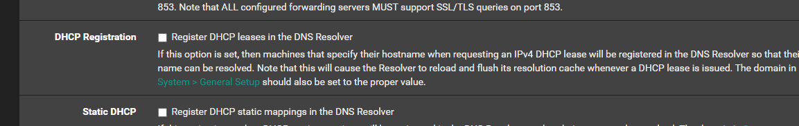

            Are you using :
            • N Offline
              NetRunner8050 @Gertjan
              @Gertjan
              No I dont use this option:

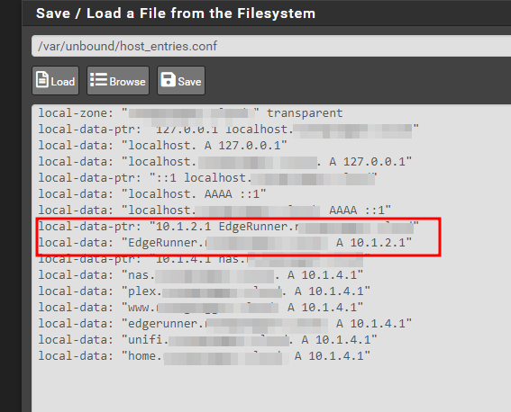

                • N Offline
                  @Gertjan
                  Those addresses are my gateway addres for the specific network.
                  Maybe I should mention that the domain is my "internal domain" and also local zone.

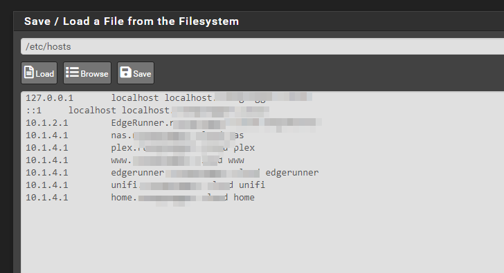

                  Yes I got those in my Hosts file:058f34bd-c04f-4d9c-b587-ba490cbed76c-image.png

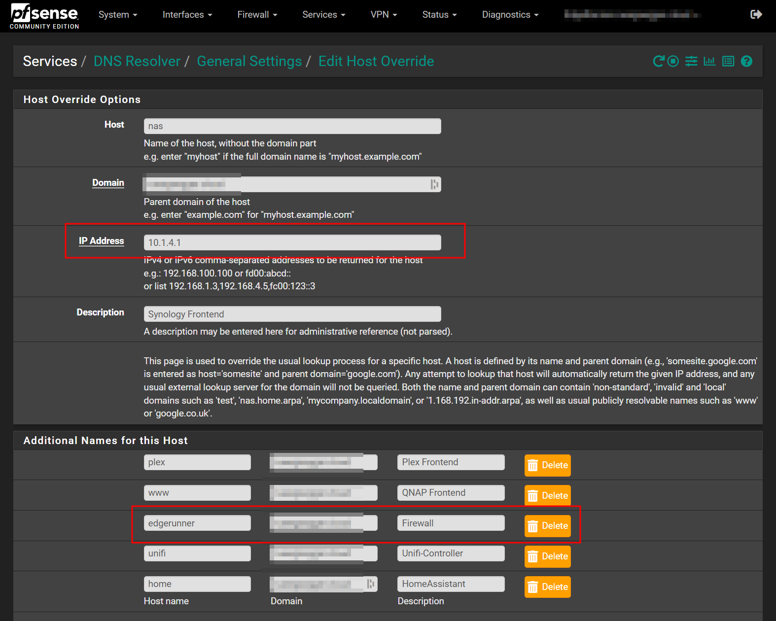

                  But I dont get this in my Host Override config
                  Nothing in my DHCP leases (I dont use IPv6)
                  There are no DHCP static mappings or anything.
                  But they are in the /var/unbound/host_entries.conf

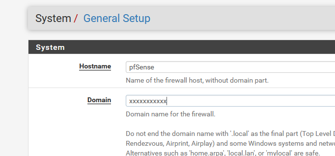

                    NetRunner8050 @NetRunner8050
                    I figured it out.
                    It was because my Firewall was named edgerunner and my domain was the xxx.xxx Domain and my LAN interface had the IP 10.1.2.1 it mapped edgrerunner to the IP.
                    My solution now was to rename the firewall.
                    Then I got the potential DNS Rebind attack error and had to add the alternate Hostname in System-> Advanced.
                    Thanks for the help!
                      Gertjan @NetRunner8050
                      @NetRunner8050
                      This :
                      comes from this :
                      edit : Ok, you have found that also.
