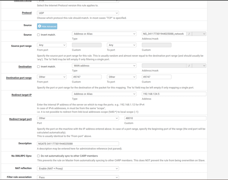

      I configured port forwarding rules for our application, to allow the client access this application, we need allow 3 tcp and 4 udp ports
      then we lauched the connections, but most time it will be failed to connect only few of chance we can connect through.

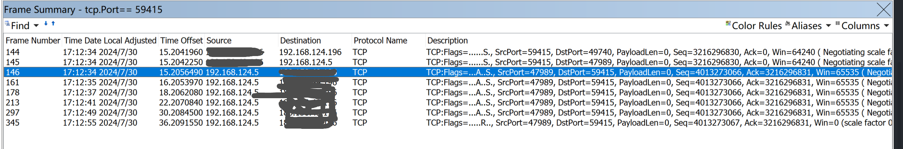

      I capture network logs on pfsense and client at the same time, from logs on client side i found many retransmit and cause the connection stopped, while i checked logs on pfsense, i found syn/syc+ack, but looks like tcp packet didn't hit on wan interface

          For NAT reflection, even we tried to use options like system default/disbaled/pure NAT, the same not working
          The thing is if I switch to use pfsense plus (23.09), which is under same subnet as pfsense CE, then the connectivity will be good;
          I am a little bit suspect there is ongoing bug with pfsense CE

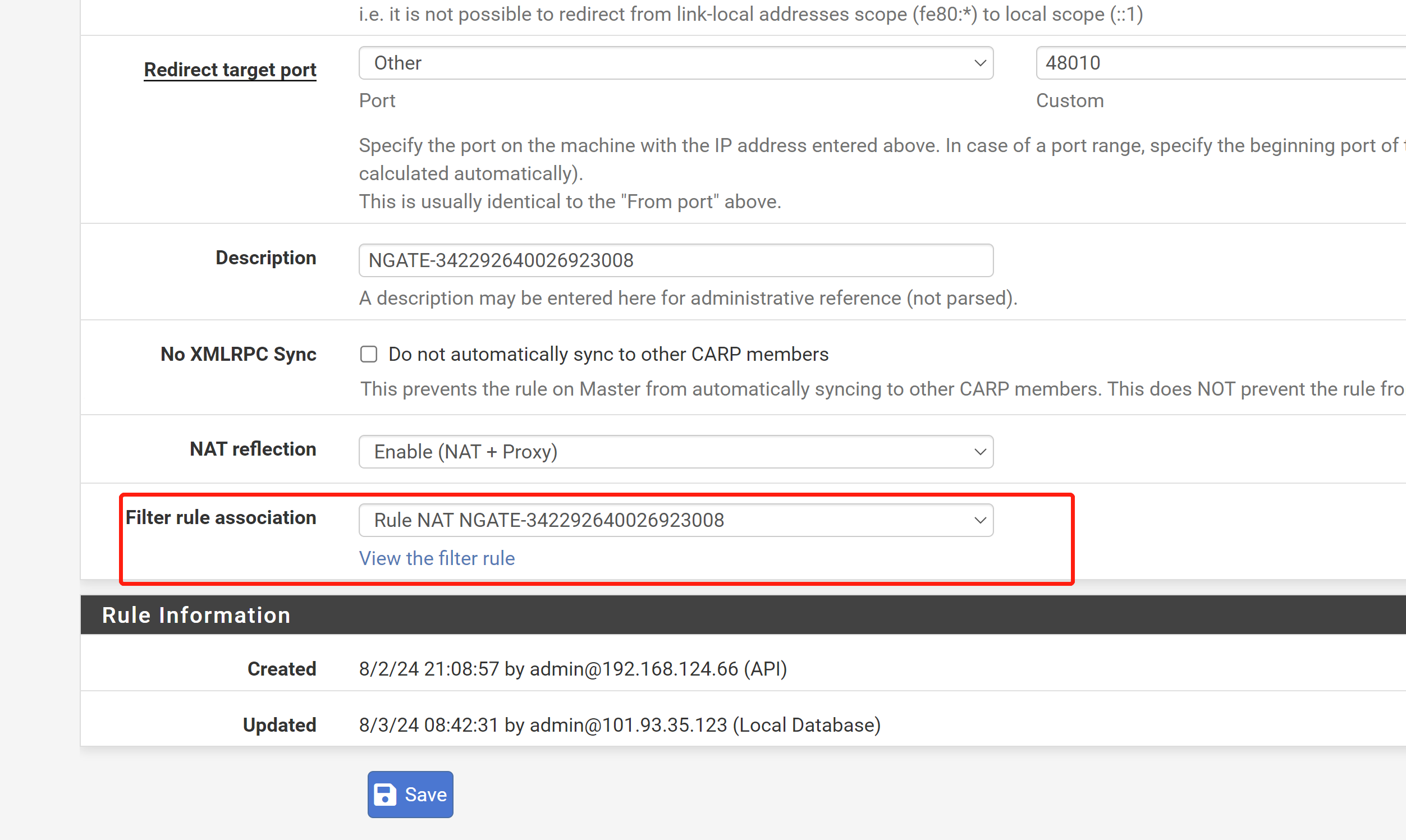

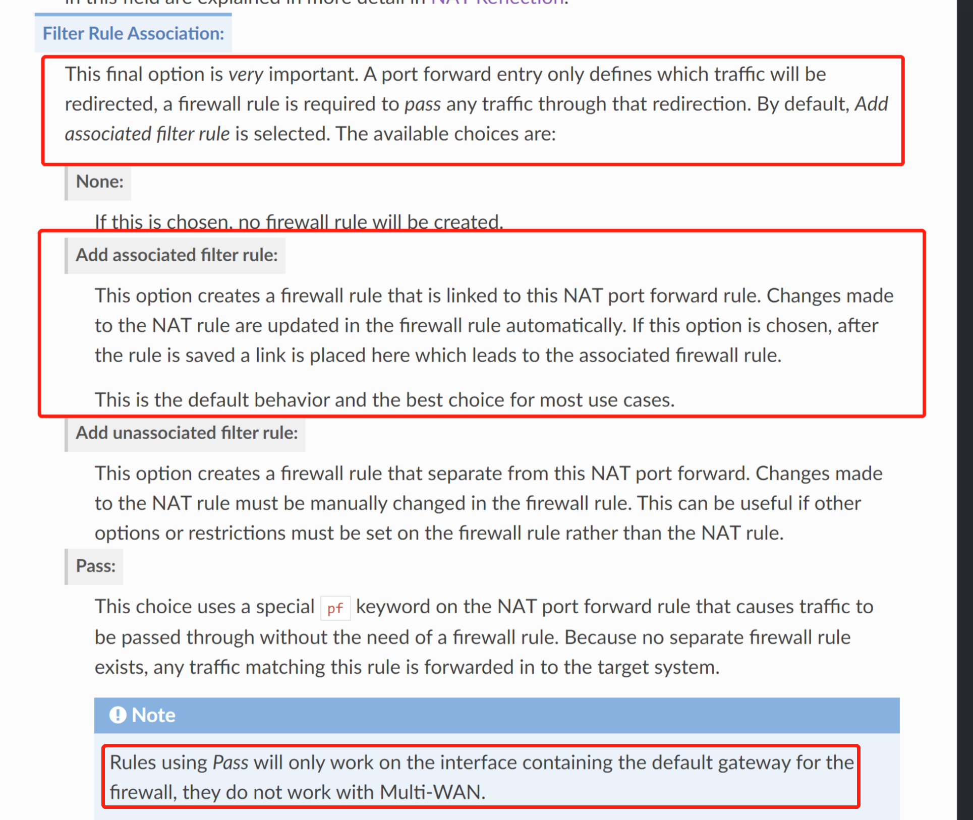

              i finally found the cause, i changed the 'Filter Rule association' from 'pass' to other, i then works
              but the thing is we have default gateway and even i allow all in firewall rule, but nat with filter rule association 'pass', nat still not forward the traffic; looks like it's the bug of pfsense
