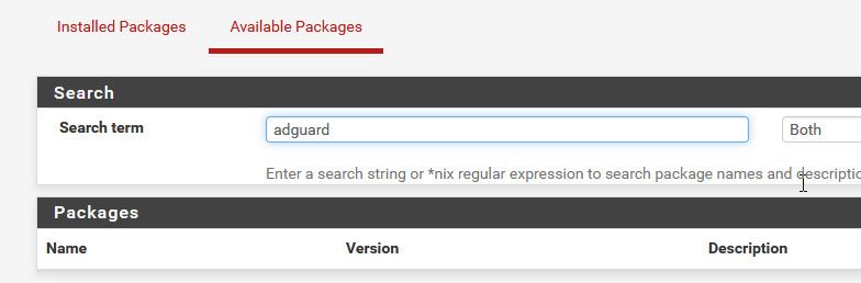

          johnpoz LAYER 8 Global Moderator @kilasin
          @kilasin why would you change it to 5353? That is the mdns port.. Where would you have gotten the idea that you could install adguard on pfsense? That for sure is not an approved package..
          Your free to do what you want, but I wouldn't be installing 3rd party packages on my firewall.. Why not just run it on something else in your network, a vm or a docker even? Maybe a rasberry pi, etc.
          edit:
          Looking over a simple guide that adguard is running on 5353, you don't change unbound port.. Your adguard is prob not working would be my first guess.
