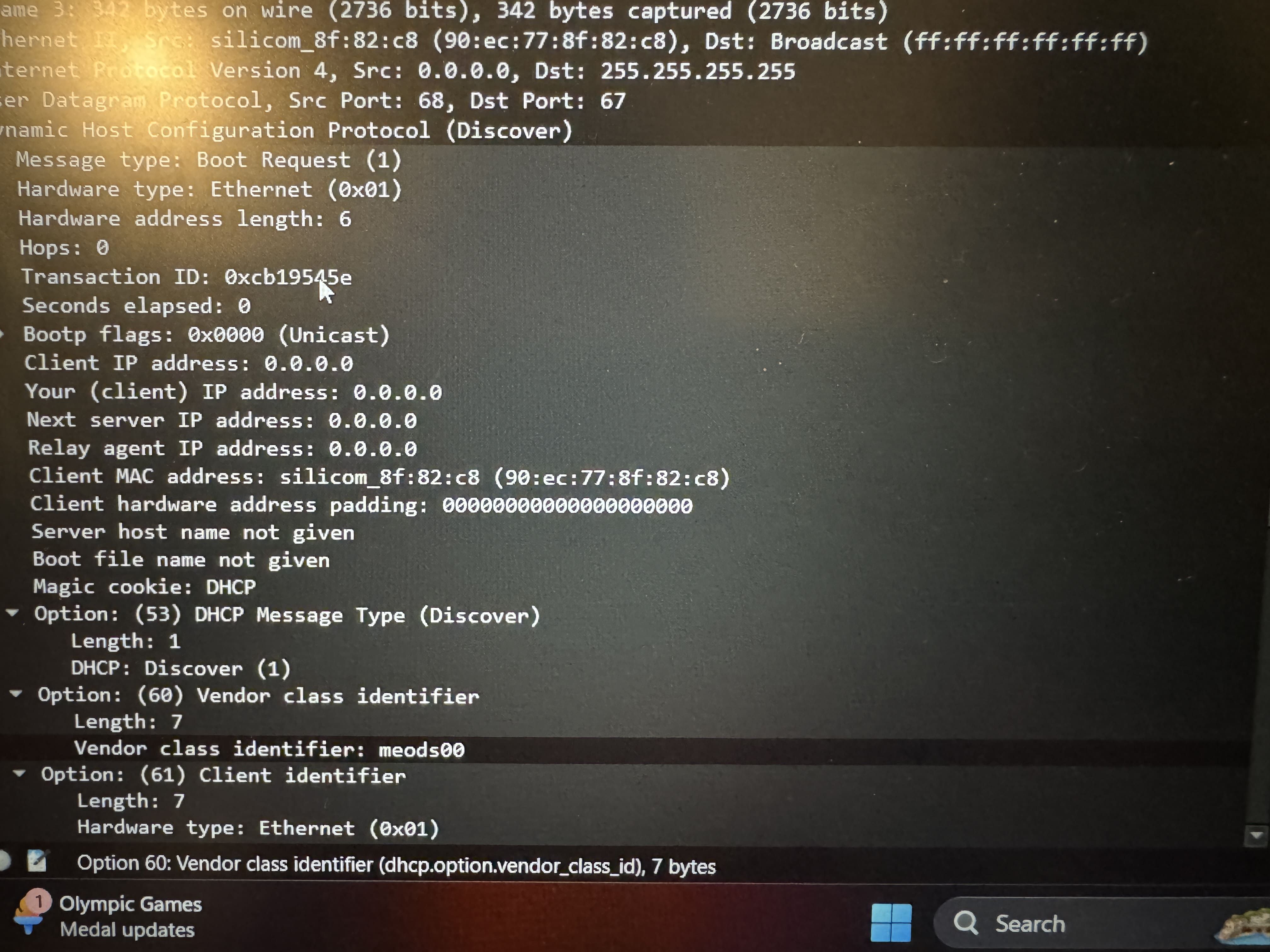

Great news! I logged into the CLI of the router and was able to capture some additional details on the WAN interface.
Interface: erouter0 MAC Address : <removed> Description: Interface_erouter0 Type: IPoE Vlan 802.1p: 0 Vlan Mux ID: 12 Vlan TPID: 0x8100 IPv6: Enabled IGMP Proxy: Enabled IGMP Source: Enabled MLD Proxy: Disabled MLD Source: Disabled NAT: Enabled NAT Type: Masquerade Firewall IPv4: Enabled Firewall IPv6: Enabled Force Disable Firewall IPv4: Disabled Force Disable Firewall IPv6: Disabled ARPPing: Enabled ARPPing timeout(secs): 900 ARPPing number of repetitions: 3 Status: Connected IPv4 address: <removed> IPv6 address: <removed> Enable/Disable: Enabled Addressing Type IPv4: DHCP ------DHCPv4------ Option 60 Vendor ID: meods00 Option 61 IAID: Option 61 DUID: Subnet Mask: <removed> Default Gateway: <removed> Option 125: DNS Servers: <removed> Remaining Lease Time(secs): <removed> ------DHCPv6------ Type: PrefixDelegation Prefix: <removed>/56 Preferred lifetime: 90000 Valid lifetime: 90000 Default gateway: <removed> DNS Servers: <removed> ----------------------------------------------
Considering the above, I need to set Option 60, and also set the DHCPv6 options. Do you think that there are any other settings I should configure on the WAN interface?

@stealthmode VendorID might be the only setting needed - it might not. Sometimes not everything is outputted in Shell command like that. But try

Mmm, what did you run to get that? I can't decide if that's what the server sent rather than the client.

I've configured the PFSense wan interface in this way
- On mvneta0.12 WAN interface, enabled
Advanced Configuration
andConfiguration Override
- Set the file as "/root/dhcp-config/dhcp.conf"
- The file contents are the following:
interface "mvneta0.12" { timeout 60; retry 15; select-timeout 0; send dhcp-class-identifier "meods00"; }
- Restarted PFsense
- still don't appear to be getting the WAN IP
Do you think my configuration is correct here?
@stealthmode Probably, but it’s hard to tell if your setup works as intended unless you do a packet capture.
I would instead not enable configuration override, and just insert:
Dhcp-class-identifier “meods00”
In the send options dialog. Then we know it will be included in the standard DHCP process from pfSense (it will also be fully restorable from a config file if you ever reinstall or move to a different device)
@keyser Thank you!
I followed what you said, and the DHCP options are being sent in the request but I still don't get a WAN IP.
So it's back to the drawing board for me :|
The ISP may require the MAC address of the ISP provided router. This would require you to spoof the MAC address into the WAN interface. Do you know if it is locked down to the original router MAC address?
