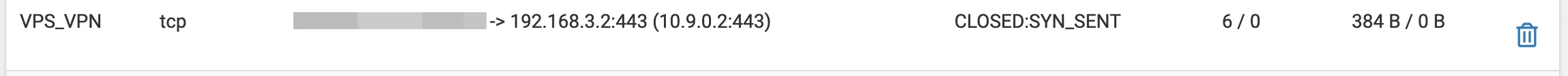

          @viragomann hey, I tried to add this rule but it doesn't work. Did I do it correctly?

            If this is on the VPS site and the alias in the source includes both of your public IP, then yes, I'd expect it to work.
            It should translate the source address in packets to the server VPN address on matching traffic.
            You can verify this with packet capture.
            If it doesn't work ensure the the request packet is routed out on WAN properly.
