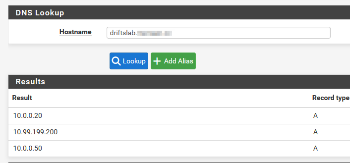

      But, the problem is when I try to use the dns name to contact the remote server. Sometimes it works, sometimes it doesn't. Checking up on what unbound returns for the DNS entry, I found it to be returning the ip's of random computers on the remote lab instead of the actual ip of the server, which is configured in the DNS.

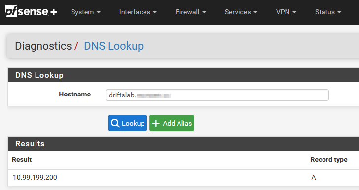

      If I restart unbound, it returns the correct address in the beginning, until traffic from a machine in the lab flows over the vpn connection, and then unbound seems to simply return the ip of the last machine that communicated over the tunnel instead of the correct address. I've even tried to define a host override for that spesific host, but to no avail.
      I thought the "Register connected OpenVPN clients in the DNS Resolver" checkbox on the DNS resolver config page should control this, but the behavior is exactly the same no matter if it is on or off.
      Screenshots below shows the problem. Immediately after restarting unbound, everything is fine and it returns the correct address, but once I put some traffic over the vpn link, the IP's of the computers on the remote side starts to be added to the vpn client's dns entry. Sometimes it doesn't even return the actual address, only the others from the lab.
