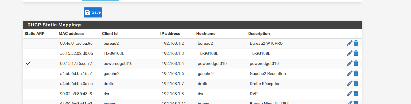

        or do you mean : it doesn't have the DNS names of the LAN devices ?
        You can solve that using : ISC (and not the KEA DHCP server) and then start adding your devices one by one :
        That is : add the devices that you want to know 'by host name', most probably the ones that host servcies like printers, NAS, etc etc - not your doorbell etc.

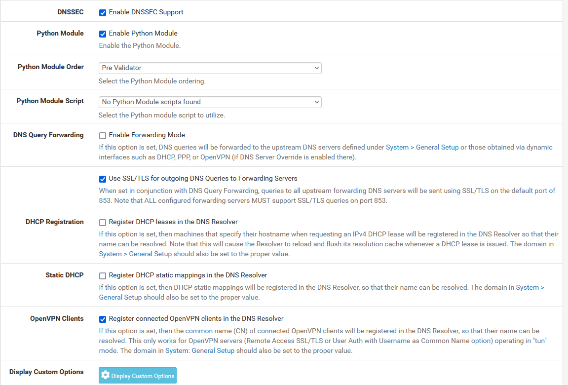

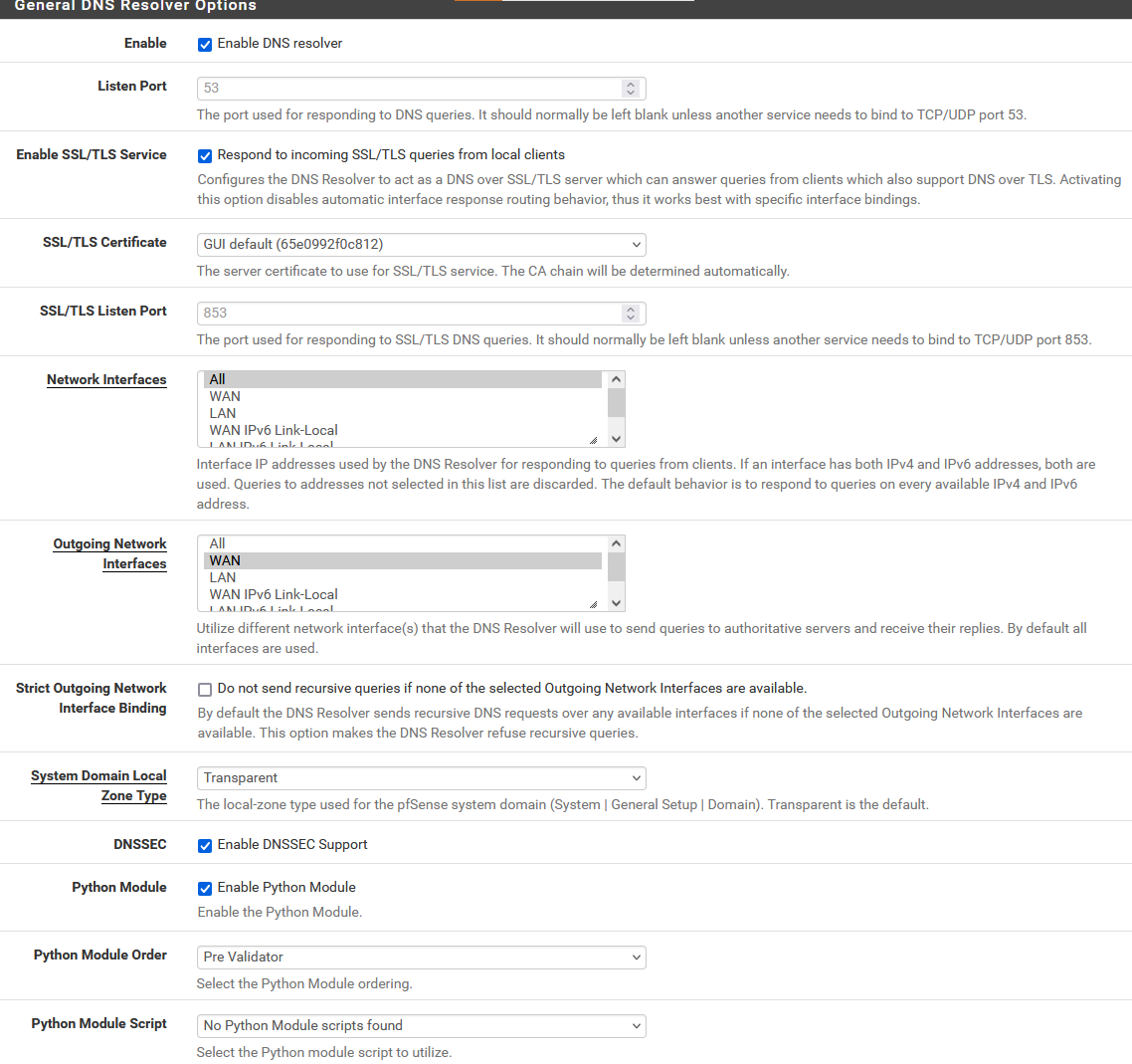

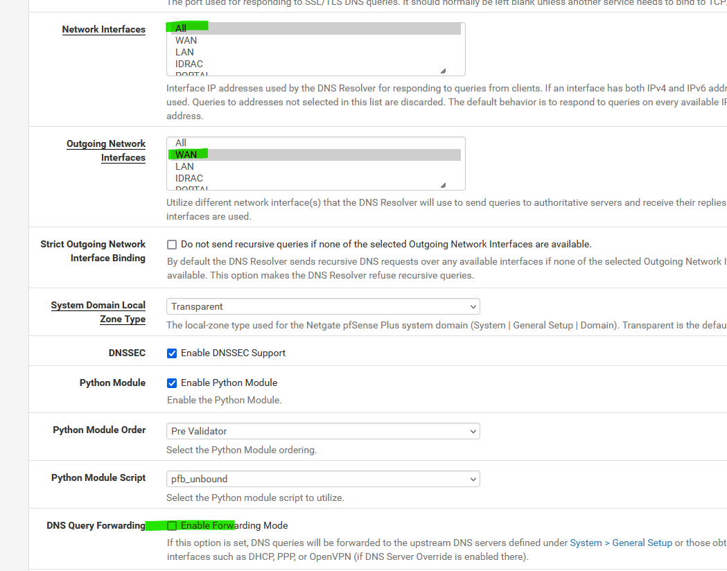

            What are you resolver (unbound) settings ?
            What works great is :
            cemsonmezC 1 Reply Last reply Reply Quote 0
            • cemsonmezC Offline
              cemsonmez @Gertjan
              @Gertjan Unfortunately, it didn't work.
              In addition, I have no option as pfb_unbound in "Python Module Script".
              GertjanG S johnpozJ 3 Replies Last reply Reply Quote 0
