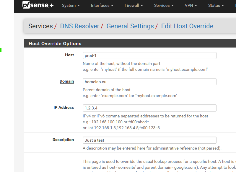

          When I enter :
          and save, and then restart unbound/resolver it works right away.
          C:\Users\Gauche>nslookup prod-1.homelab.cu
          Serveur :   pfSense.bhf.tld
          Address:  2a01:cb19:dead:beef:c3c:77ff:fe29:392c
          Nom :    prod-1.homelab.cu
          Address:  1.2.3.4
          My WAN is always connected.

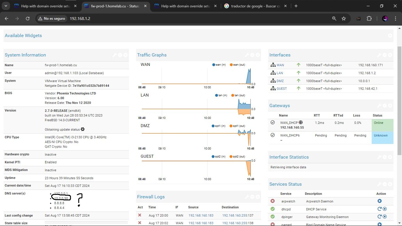

          @krlsantcard said in Help with domain override setup:
          Servidor: UnKnown
          Address: 192.168.160.55
          Strange.
          Is this 192.168.160.55 your pfSense LAN or other LAN (OPTx) interfaces ?
          Is unbound listening to this interface ?
          This will do just fine :
          Not related, but scary : .55 and not .1 or if you have to .254 ... No reverse for your pfSense ?
          I'm using the default (Netgate) resolver settings, so my resolver resolves.
          johnpozJ 1 Reply Last reply

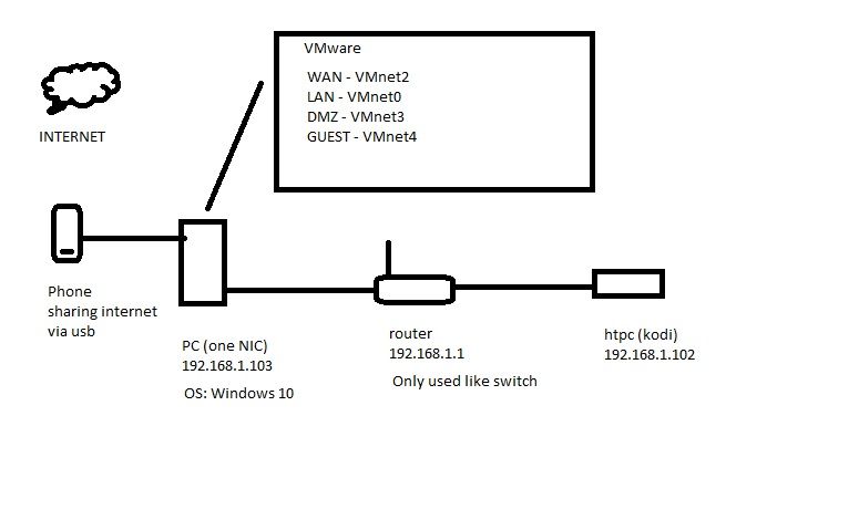

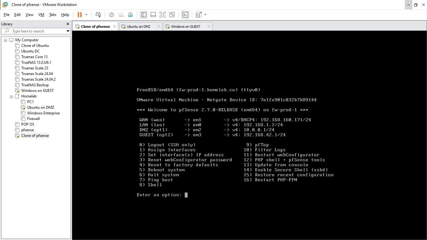

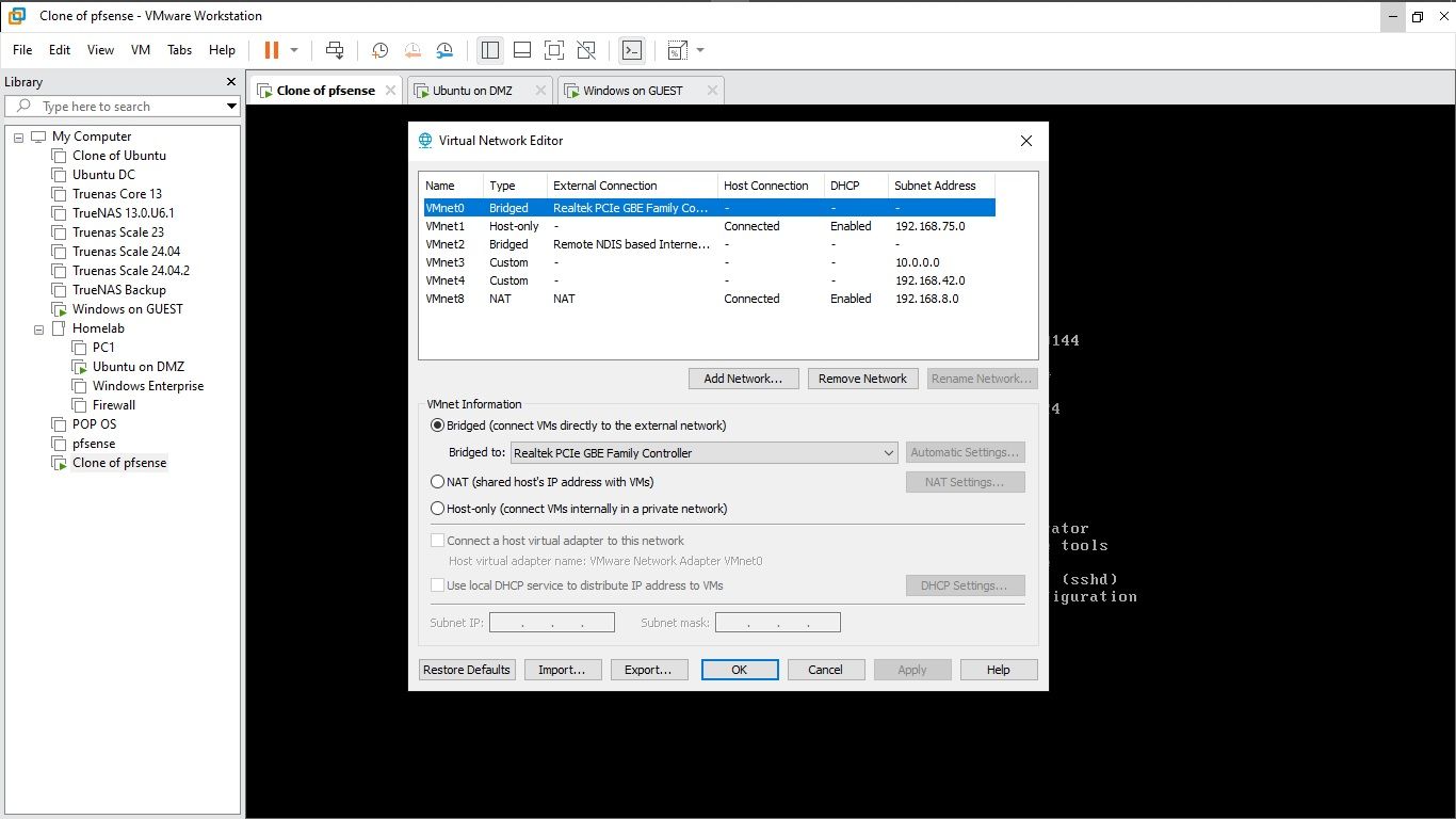

                    I have all virtualize on VMware on my PC (one NIC).
                    my customs adapters
                    and here my networks from window
                    and in pfsense setup
                    from GUEST network all work fine or maybe??
                    but from LAN a ping to DMZ never respond,
                    how ever ping to GUEST respond well.
                    rules are open to any.
                    Any idea???

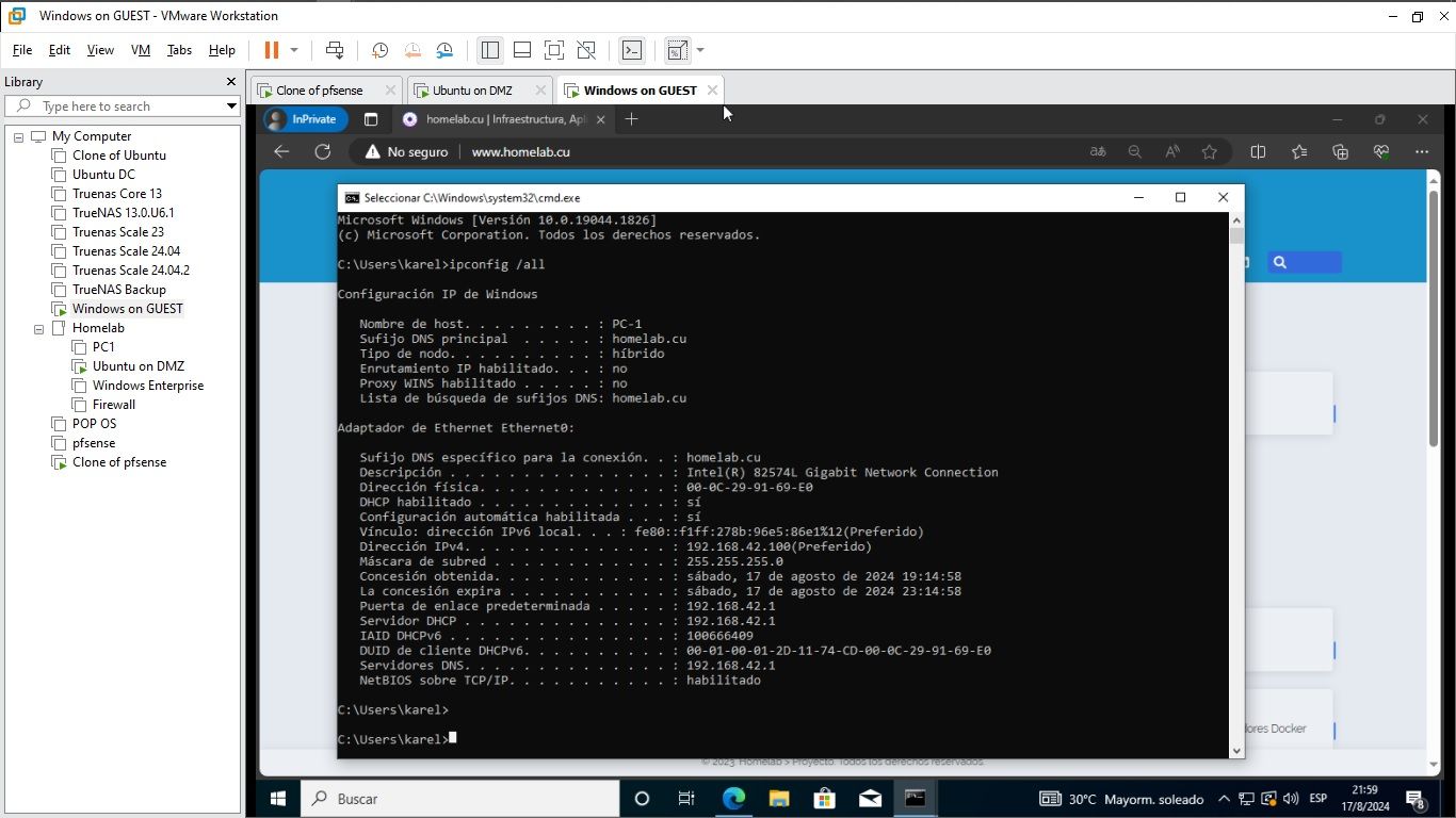

                      ipconfig on GUEST network,
                      K 1 Reply Last reply

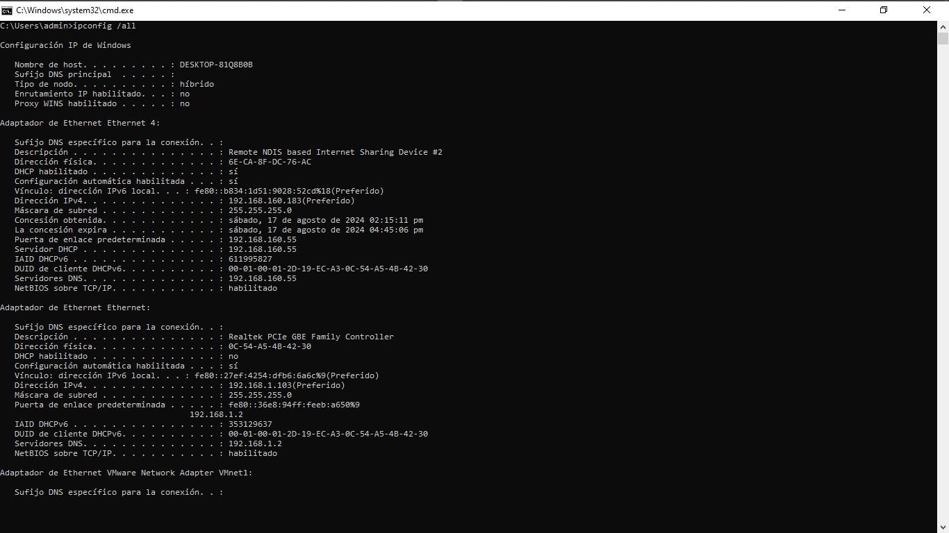

                        ipconfig in LAN
                        Is it why never resolve. ????

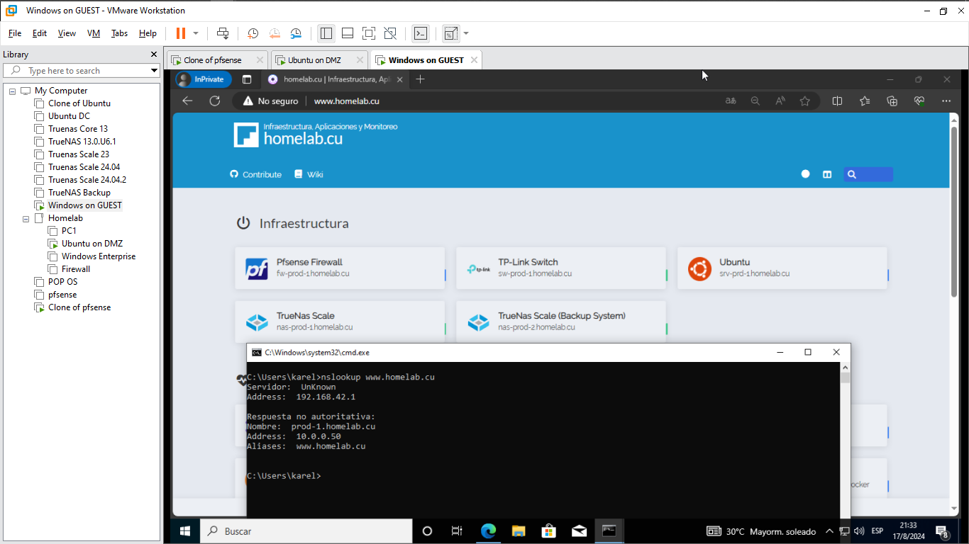

                            @Gertjan Problem Solved!!!!
                            Yes i dont know why but was related to virtualizations.
                            Just put de VM on the subnet of LAN and get all via DHCP and resolves all like a charm!!!!.
                            Now from any subnet work great. i almost give up.

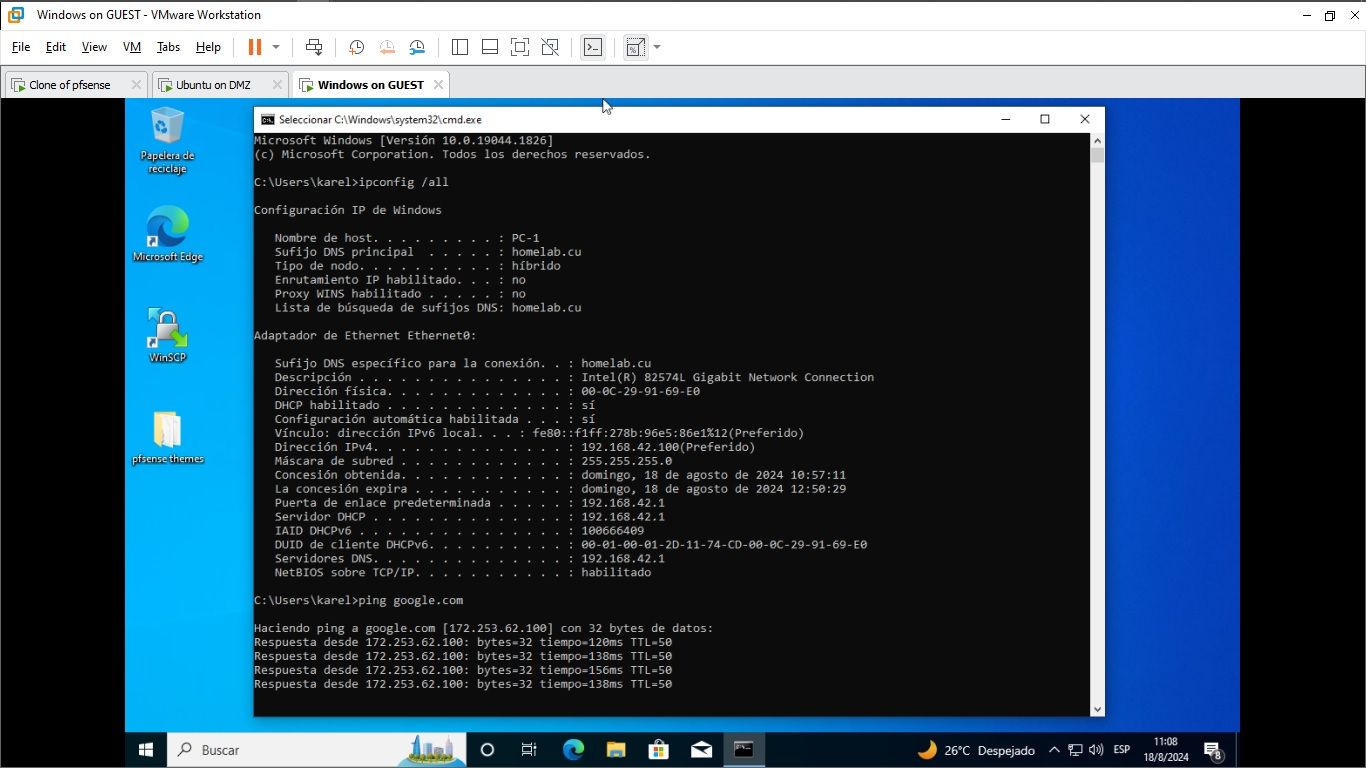

                                      Well, following ur sugestions remove all dns.
                                      Client in GUEST (get via DHCP)
                                      Is that correct???
                                      And a ping to google.
                                      then in browser:
                                      DNS_PROBE_FINISHED_NXDOMAIN
                                      just made a flushdns and problem resolved.
                                      so that's the way should be?
