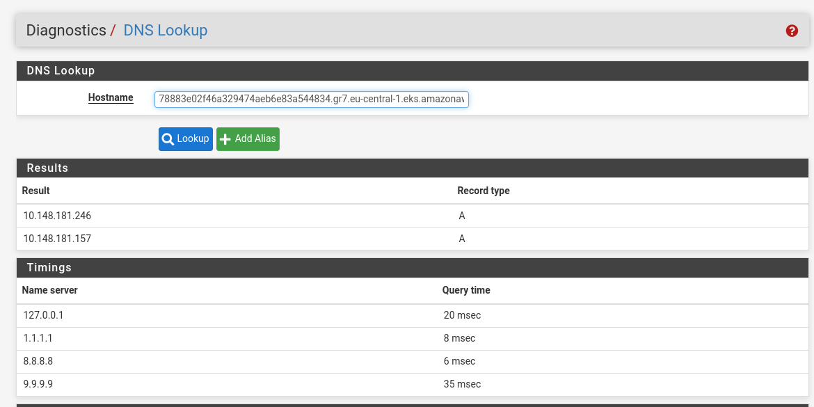

      hello,
      Today I realized that I'm getting issues to resolve aws names like:
      "78883e02f46a329474aeb6e83a544834.gr7.eu-central-1.eks.amazonaws.com"
      using the pfsense diag_dns.php webpage.
      if I disabled both dns forwarder and dns resovler it can lookup the ip address,
      however
      as soon as I enable any of them it includes de 127.0.0.1 query server and gets host not resolved.
      Any idea on what setup I'm doing wrongly?

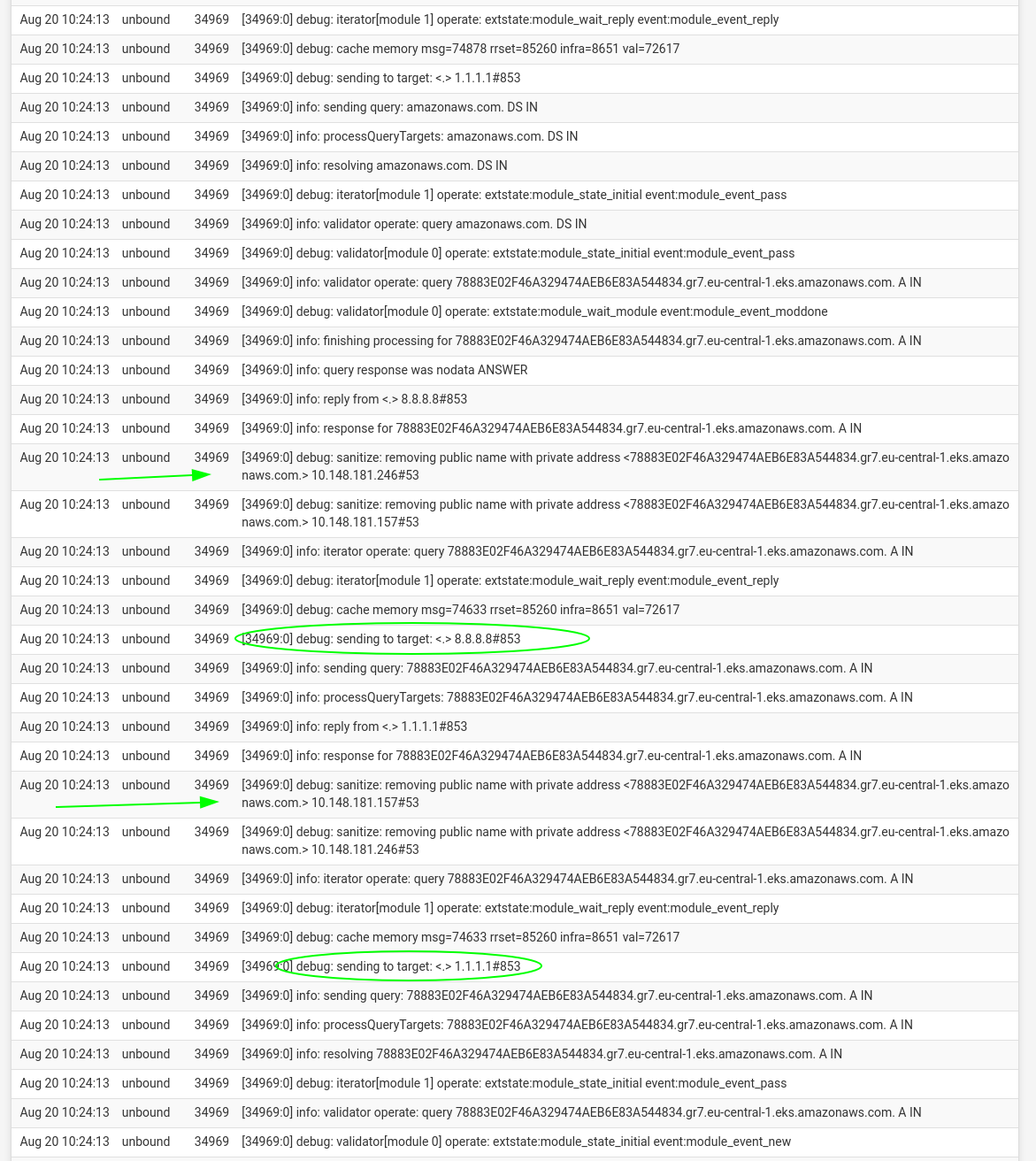

          I enable debug info. and as you mention looks like unbound is bloquing that answer.
          I hope you can see in the picure the query is sanitized.
          I will need to figure out if it is posible wo white list some options and how safe it would be.

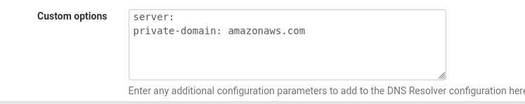

            I complete my previous message as a quick google search gave me the answer:
            https://blog.jenningsga.com/pfsense-dns-resolver-and-private-domains/
            I need to add this. to the custom options:
            So that now it allows weird things from amazonaws.com.
            Thanks every one for your help.
