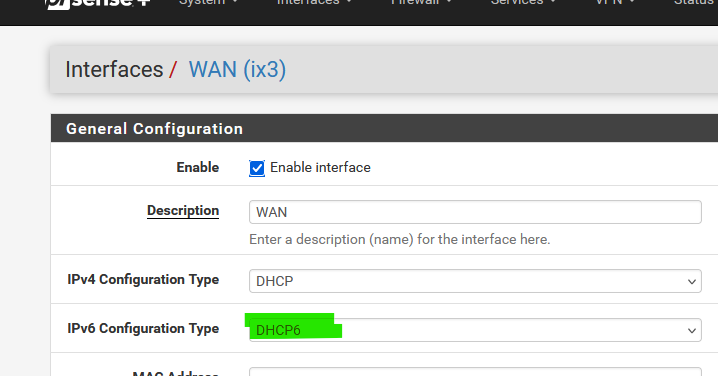

        So on WAN, IPv6 is active as dhcp6c is active.

          I can't get in the GUI so I dont know the WAN configuration type. I'm pretty sure IPv6 configuration type should be none. Is there a way to check this in single user mode?

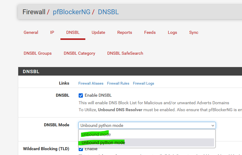

            That file is created bt pfBlockerng when you use the old 'unbound' method.
            These days, it's its the 'python' method.
            But you can chose :
            The classic, now called "unbound" method takes all the DNSBL files, and assembles it into one big dnsbl file, That's this file /var/unbound/pfb_dnsbl.conf. Its regenerated on every 'dnsbl feed update'.
            The python method was invented (by the authors of unbound themselves) as it is faster/better for unbound to use a plugin that maintains the dnsbl file(s).

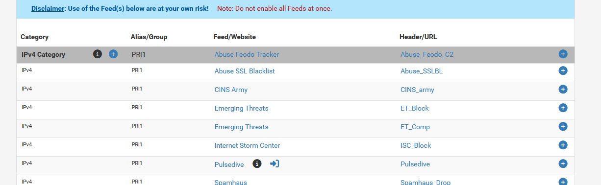

            If you have just some small dnsbl feeds, there is not really a difference, but thenthe obvious was happening : people started to click select them all :
            (the entire page, so millions and millions of DNS hostname entries.
            Upon restart, unbound took dozens of minutes just to 'start' because it had to parse the xx millions lines file. And during that restart,; DNS is 'out'.
            Furthermore, parsing huge files with PHP .... that's asking for troubles ....
            With the python approach, there are still limits, but its way faster/better.
            And for free : even more stats and filter possibilities.

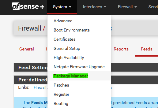

            Things would be way more stable if this one was taken out :
            ( you could also decide not to use it ^^ )
            By adding 'more gadgets' (the other name of pfSense packages) you bring more bugs into your system.

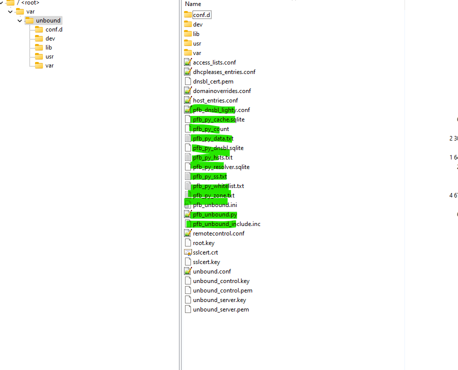

                Next step :
                When unbound start, most of the needed config files are recreated from 'scratch'.
                Just to be sure : rename these files :
                as they are pfBlockerng related.
                As said, the other files in there are re generated anyway.
                Now, reboot, and unbound should start whiteout a hitch.

                  I also dont have any of those pfb files in /var/unbound except for the .conf file I mentioned.
