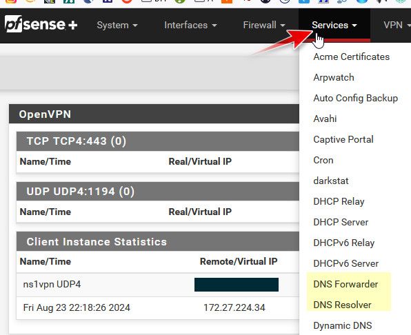

                  @chachew you don't need to install it - its built in.. There are 2 dns options builtin, unbound (resolver) and forwarder (dnsmasq).. Also a 3rd option you could install Bind.
                  But out of the box pfsense would use unbound and resolve..
