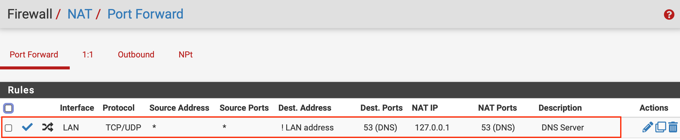

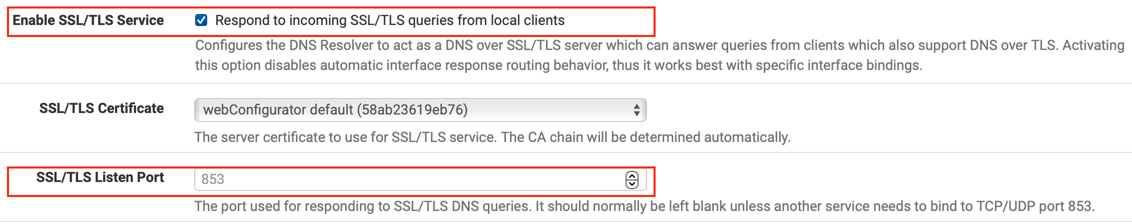

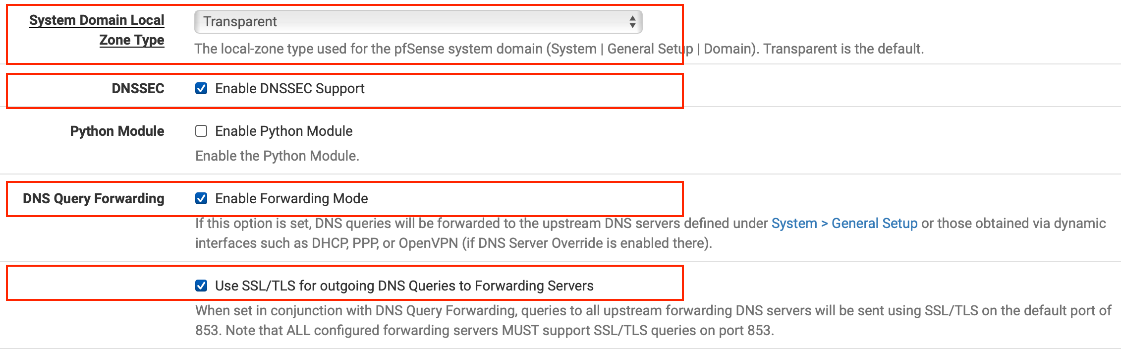

          This is what I do. End result is all unencrypted outbound DNS queries will be redirected to the local DNS server, which will encrypt all outbound queries. I ran a packet capture to confirm there are no WAN side outbound unencrypted DNS queries.
          1. DNS Resolver settings
          1. Add a NAT rule to redirect all unencrypted outbound DNS queries to the local DNS server, just in case some clients hard code their DNS servers.

            @elvisimprsntr Why did you enable DNSSEC support? There are a lot of warnings that DNSSEC support would can cause issues with DoT. And it's unencrypted since DNSSEC verifies the DNS server's identitiy only.
                  I’ve not had any issues.
