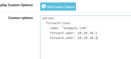

        Custom options should look like :
          jakub.krauz @Gertjan
          @Gertjan Thank you for your response. I tested with the custom options as you suggested, but it gave me the same results as previously with domain overrides.
