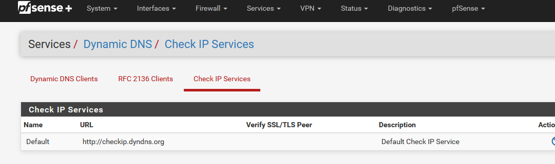

      Go here :
      You see the URL ?
      Click on it :
      http://checkip.dyndns.org
      You should see your WAN IPv4.
      pfSense uses the same URL to obtain the same info.
      Or, it didn't work out.
      [24.03-RELEASE][root@pfSense.bhf.tld]/root: curl http://checkip.dyndns.org
      <html><head><title>Current IP Check</title></head><body>Current IP Address: 82.135.26.241</body></html>

          But this has nothing to do with the "DDNS supplier" :
          @ascabral said in GoDaddy DDNS error:
          Public IP address could not be extracted from Check IP Service
          as this is a test been done locally by pfSense and can only fail, imho, if local DNS has been messed up.
