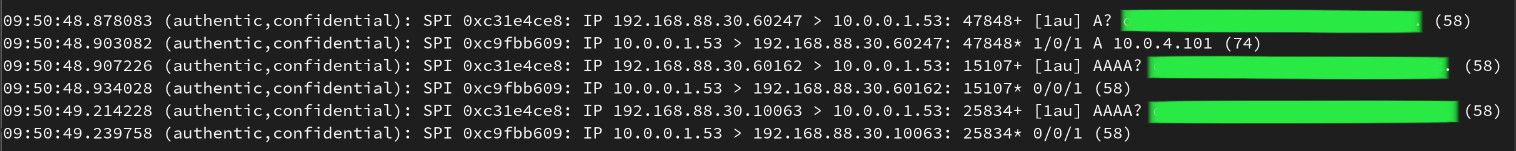

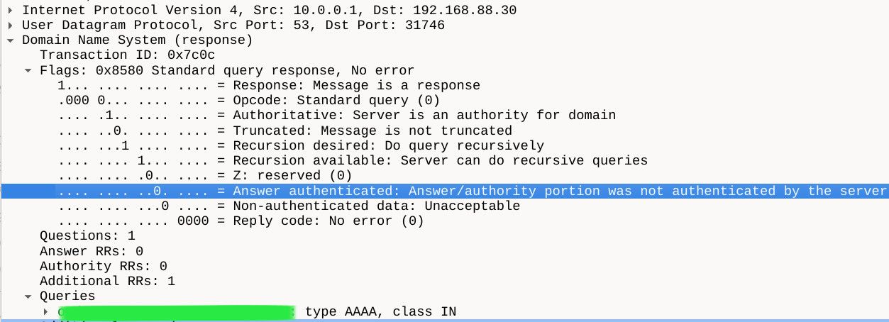

                      johnpoz LAYER 8 Global Moderator @rtadams89
                      @rtadams89
                      What zone type are you using btw, transparent (default) or static or something else? And what acls do you have set?
                      I tried duplicated your setup with 2 different pfsense, my normal pfsense using home.arpa, my 2nd pfsense uses test.mydomain.tld and it does the same thing with A records..
                      So I can ask it for a name I created on my 2nd pfsense nas.test.mydomain.tld I get an answer

                      here is asking for that same nas fqdn with AAAA, which there is no record for
                      $ dig @192.168.9.34 nas.test.mydomain.tld AAAA
                      ; <<>> DiG 9.16.50 <<>> @192.168.9.34 nas.test.mydomain.tld AAAA
                      ; (1 server found)
                      ;; global options: +cmd
                      ;; Got answer:
                      ;; ->>HEADER<<- opcode: QUERY, status: NOERROR, id: 3482
                      ;; flags: qr aa rd ra; QUERY: 1, ANSWER: 0, AUTHORITY: 0, ADDITIONAL: 1
                      ;; OPT PSEUDOSECTION:
                      ; EDNS: version: 0, flags:; udp: 1432
                      ;; QUESTION SECTION:
                      ;nas.test.mydomain.tld.         IN      AAAA
                      ;; Query time: 1 msec
                      ;; SERVER: 192.168.9.34#53(192.168.9.34)
                      ;; WHEN: Mon Sep 23 14:12:25 Central Daylight Time 2024
                      ;; MSG SIZE  rcvd: 50

                                      • If a query B2 for an host on the overridden domain, I get the expected reply for the "A" record and an error for the "AAAA" record
                                      • If a query B1 for the same, I get the expected reply for the "A" record and empty result for the "AAAA" record
                                      I've attached:
                                      • DNS status screenshot after the query of P2
                                      • tcpdump output on P1 showing the dns requests
                                      • dns reply on wireshark
                                      It seems that empty answers are treated like timed out answers.
                                      Is this the expected behaviour?
